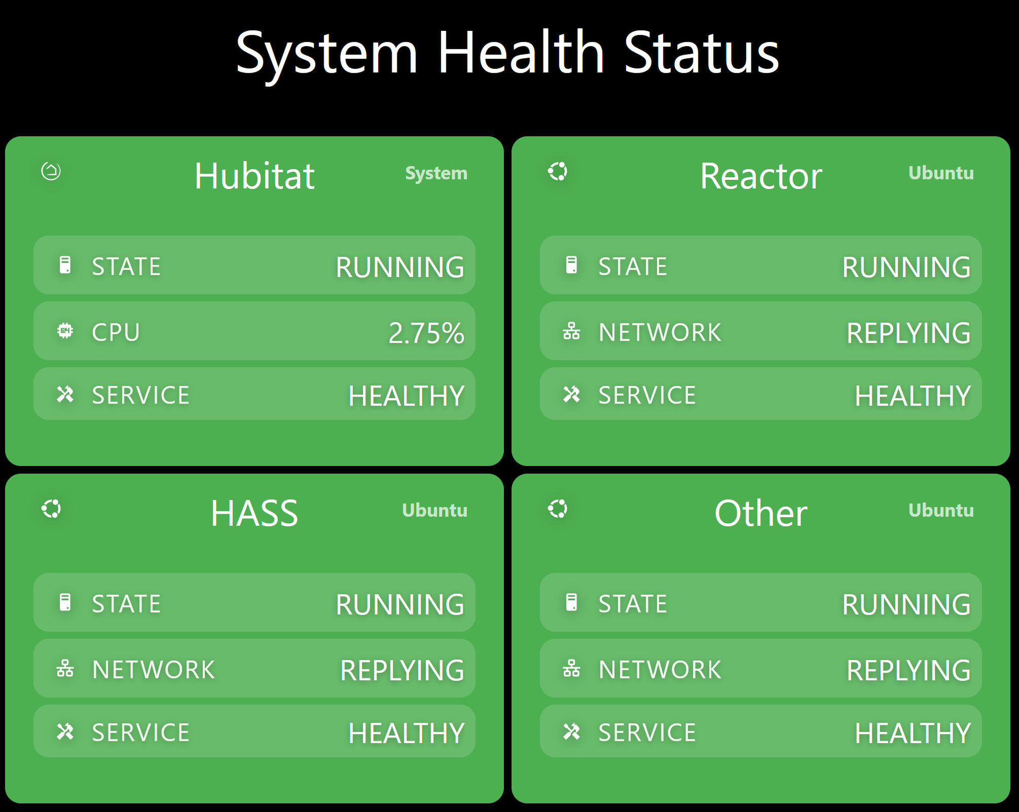

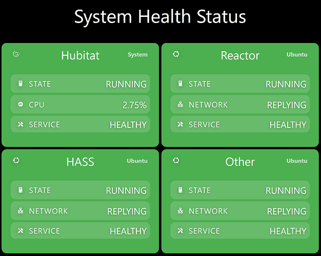

Hi!
I’m not sure if you’d be able to monitor this directly through Sharptools, because it involves several information-retrieval routines.
Note that I set up something similar to what you’re trying to do.
In the case of Hubitat, the hub itself has a tool called Hub Information that provides over 100 pieces of information about the platform; I used the most relevant ones.
For my three VMs, I installed a Python server on Windows and, using ClaudeAI, set up several hooks that are queried to generate the information. In my case, I use MSR Reactor (Reactor - Multi-Hub Automation) to handle all my automations; it calls the hooks and then feeds variables into Sharptools to display the information.

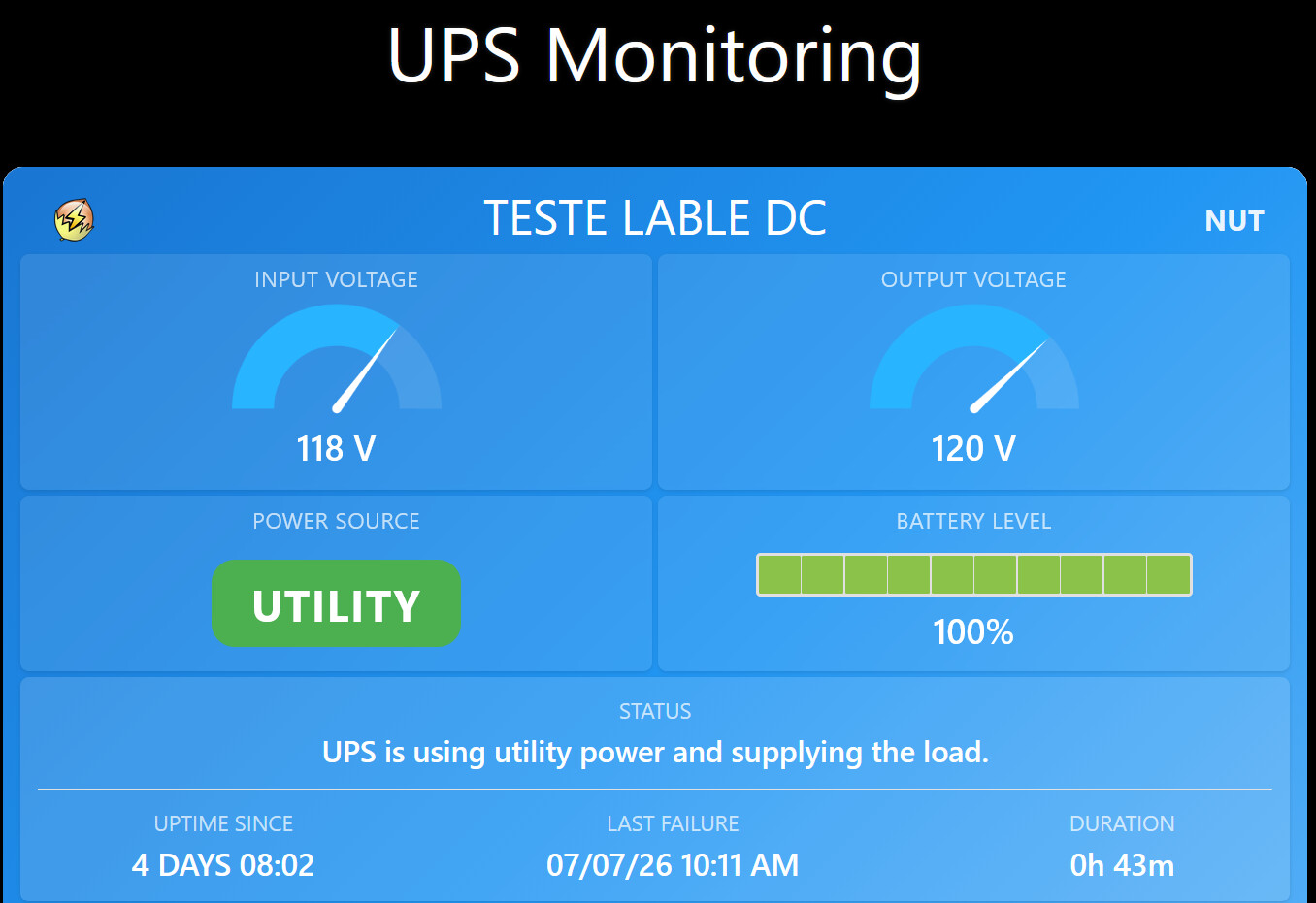

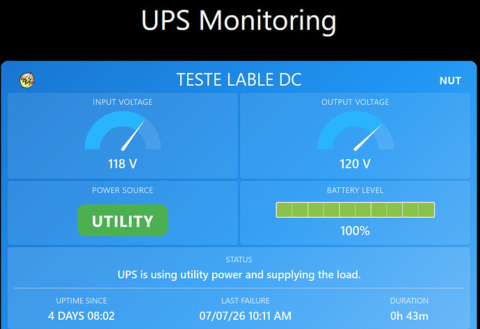

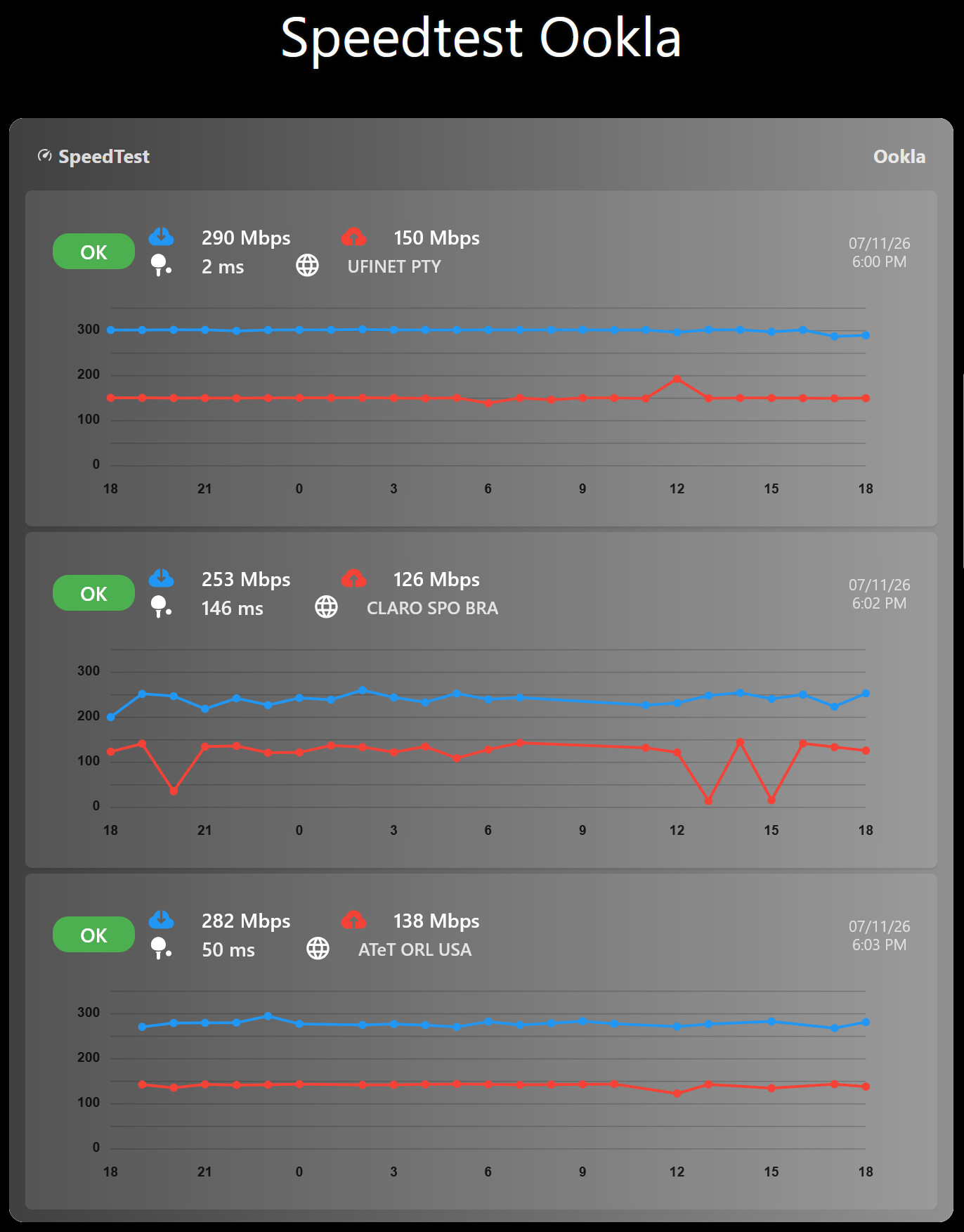

I used this same method in two other tiles I posted here, and I think it’s a method you could use as a reference.
All of these tiles are fed by external data stored in Sharoptools variables.
I hope this was helpful.
