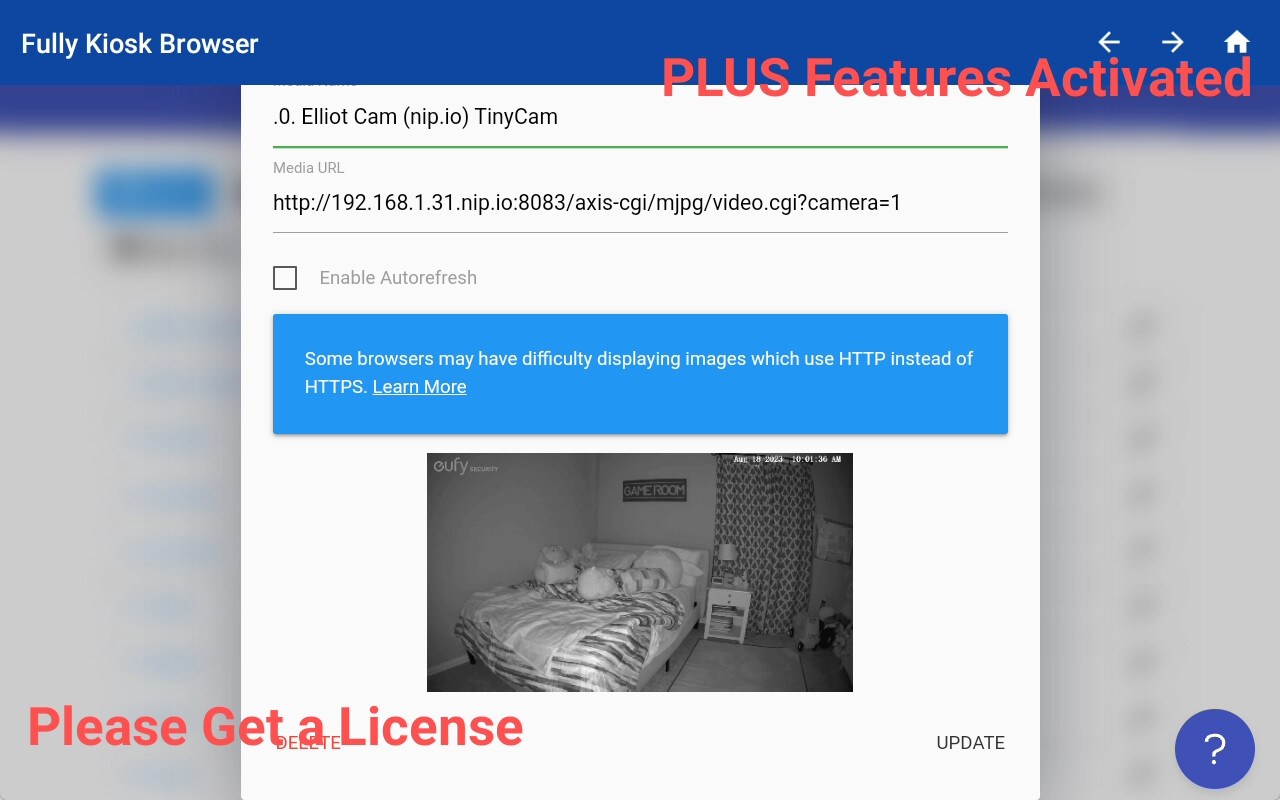

Fire HD 8 Test
I just tested on a Fire HD 8 Plus (10th gen) with the version details shown in my screenshot below and it worked for me.
  • It was showing Fire OS 7.3.2.7 installed from February or earlier. After that, I went through a ton of updates manually.
  • Unfortunately, I forgot to check the Webview version with my original test, but you can see the version details in my screenshot below.
  • You can access the ‘Device Info’ from my first screenshot within Fully Kiosk Settings → Other Settings (bottom) → Device Info (bottom)
