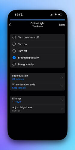

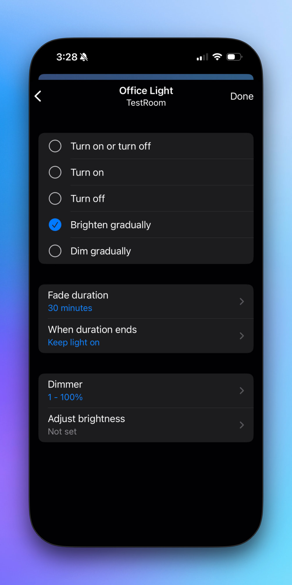

If you setup a lighting group in Smartthings you can do this fade natively, but it does require 2 lights
It’s a combination of two things. The free tier has significantly less usage than the premium tier and the Fade Macro sends 20 individual device commands over the 30 minute window. So it’s lots of little API calls rather than a single one.
It looks like SmartThings Routines support a Brighten Gradually feature, so I would consider moving that automation there.

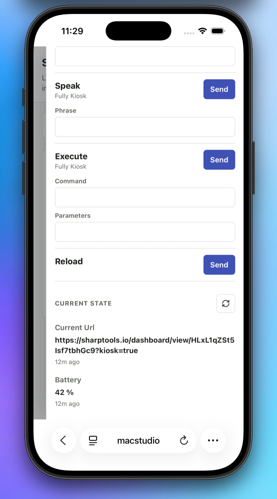

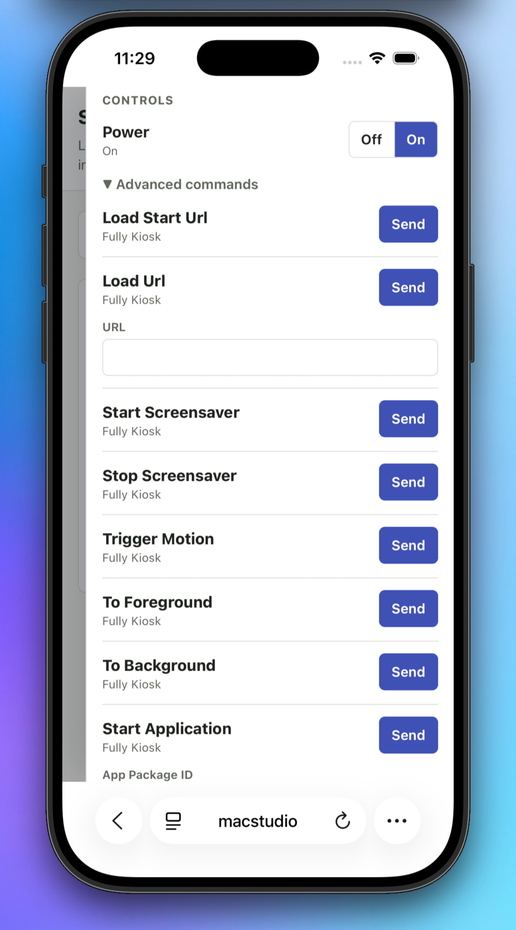

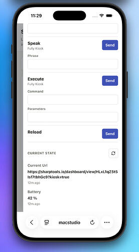

I’m pretty sure some of my usage is as a result of using your Fully Kiosk Browser Edge driver. Have you considered updating that (not even sure it’s possible) so that more can be handled on the smartthings routines side vs Sharptools side?
It’s implemented as a regular device driver, so in theory SmartThings could access all the features of it, but I’ve heard other people say SmartThings Routines don’t expose common commands like refresh() and instead have a restricted set of commands they support in Routines, so routines probably can’t access many of the helpful commands the Fully Kiosk driver implements.
That being said, there are Fully Kiosk drivers for other platform integrations that we support if you have any of those hubs. Or the SharpTools Bridge I mentioned a few times above has a native Fully Kiosk Driver as well.

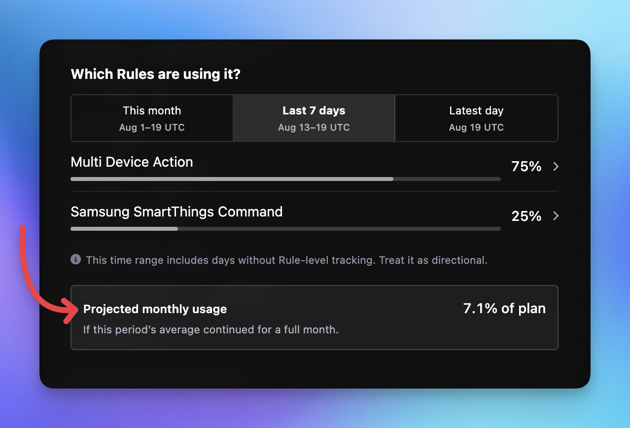

A small suggestion: rather than showing the usage by app as %total use for the period by app (so sum across apps is 100), show them as percent of the allowed maximum for that period assuming equal distribution of allowance over the interval. In this way, when I make adjustments, I can see what percent of the allowance it will be for a big user app after a day or so. In this way the highest using app would likely show a number greater than 100% if I have a problem app.
Sooo… I haven’t been home in days. The only rule that could have run is one tied to my phone (fully charged kiosk change). Yesterday was at 77 percent. Checked this morning, use is now 115.
I pushed an update last night that I believe addresses this. When you have a time range selected in the Top Rules section, it now shows a Projected Monthly Usage.
Keep in mind that this is a simple calculation that just projects what the monthly usage might be if that same usage pattern for the selected period continued for an equivalent full month. It’s only considering that selected window though: using ‘Latest Day’ as an example, it’s projecting what a full month would look like for that repeated daily usage. It does not use the month-to-date usage as a starting point and project forward for Last 7 Days or Latest Day, but is rather a fresh full month projection based on the selected time period.
But it’s helpful reference to be able to look at the Latest Day (most recent full UTC day), after making rule changes and waiting, to get a feel for if the projected usage is lower compared to the Last 7 Day projection or Month To Date projection for example.
