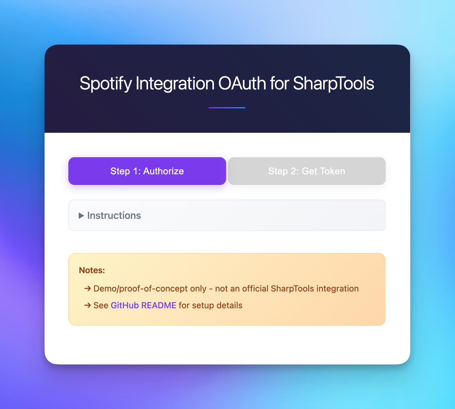

  1. Go to https://spotify-demo-auth.sharptools.workers.dev, and follow the instructions to authorize this demo app to access your Spotify account and take a note of the Refresh Token.

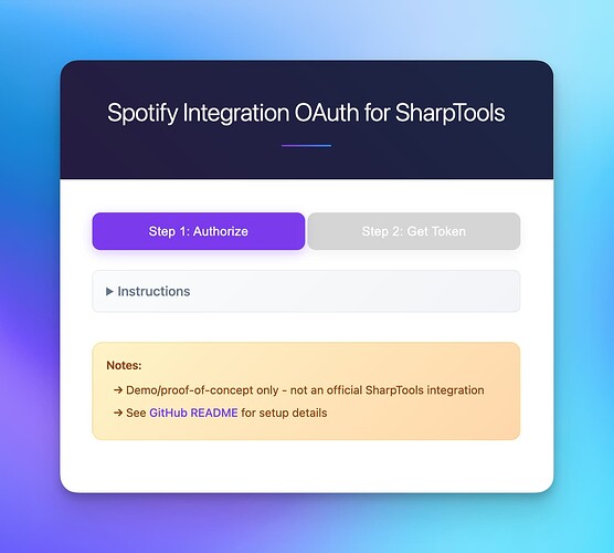

1.Go to https://spotify-demo-auth.glitch.me/ again
2.Tap Step 1: Authorize (You should not be asked to agree to authorize the demo app again because you already done that, but if it asks you again, clicks ok.)
3.Tap Step 2: Get Token
4. If the tokens are received correctly, you should see the optional test option below.
5. Click on Get Available Devices and copy the complete results
6. Send me the results from the previous step along with a screenshot of your Spotify demo tile.
