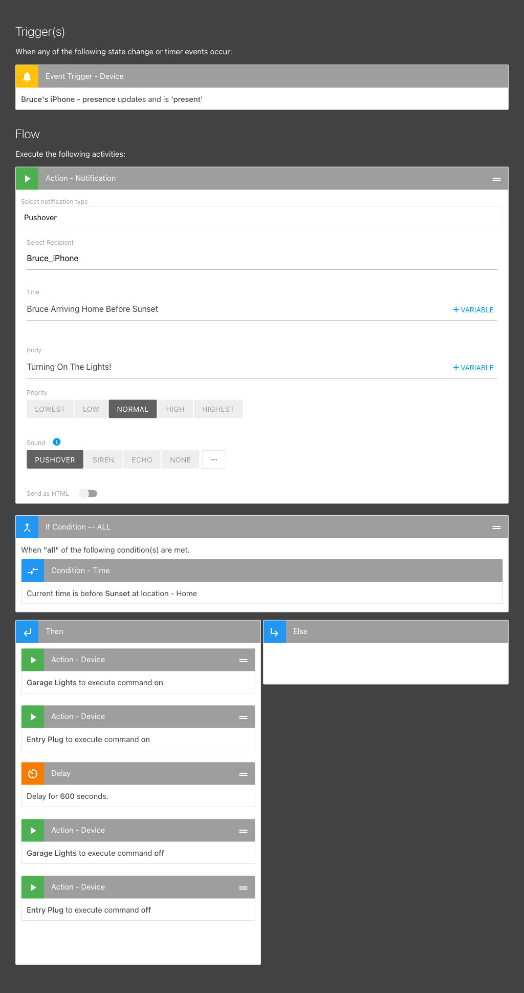

I’ve set up this rule, but it’s not firing. Would appreciate a second set of eyes on it. Thanks!

I gave up on trying to use a Smartthings routine for this. Right now, I have two rules for myself and wife to turn on certain lights before and after sunset. I’m using Pushover for notification and noticed that I receive a notification for both rules when it runs. Any idea why this may be happening? Thanks

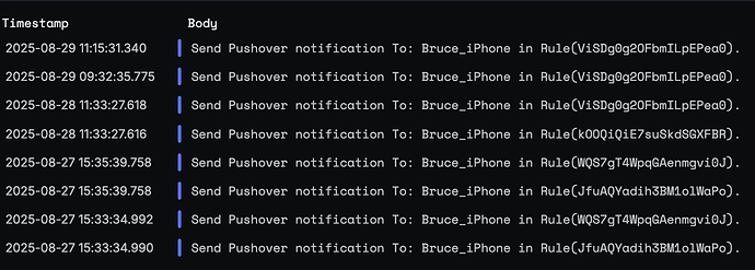

I have another rule just like this one except it’s for my wife. I’ve disabled all rules except this one. When I arrive home I get two notifications. One for this rule and the other for a disabled rule when I arrive after sunset.

It looks like the last ‘double’ notification was on 8/28 at 11:33:27 AM CDT from the rules:
- Bruce Arriving Home Lights After Sunset (
kOOQiQiE7suSkdSGXFBR) - Bruce Arriving Home Lights Before Sunset (
ViSDg0g2OFbmILpEPea0)
And the ‘Arriving Home Lights After Sunset’ rule appears to have been updated ~15 seconds after that at 11:33:42 AM CDT and there haven’t been any ‘double’ notifications since then.

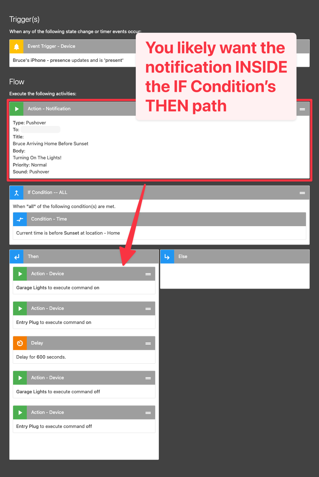

Also note that in your rule design, you are always sending the pushover notification whenever the presence changes to ‘present’. Based on the text of the message in your screenshot, I suspect you probably want it to be the first action inside the THEN path of the condition so it’s only sent when it’s actually before (or after) sunset.
You would need to delete the existing Pushover notification and recreate it inside the THEN path.
