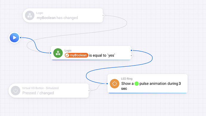

I cut down the flow so it just does a pulse animation. It works when I test it from the flow editor. The custom tile seems to be unable to start the flow (Enable Tracker).

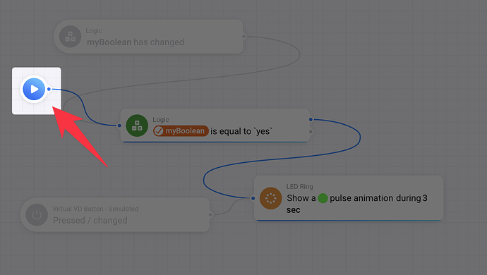

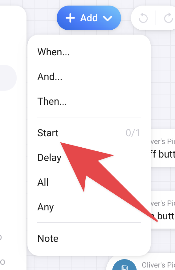

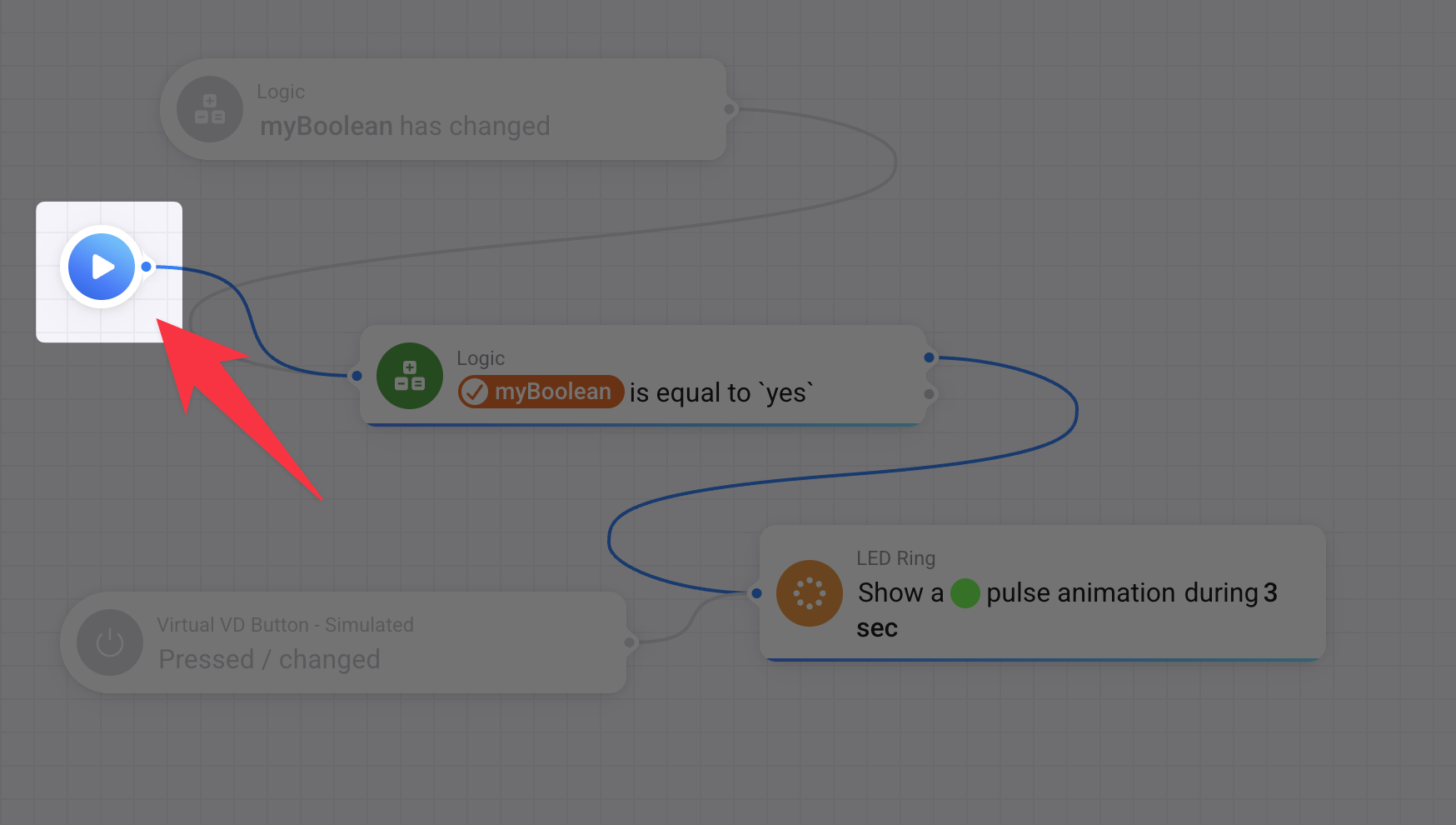

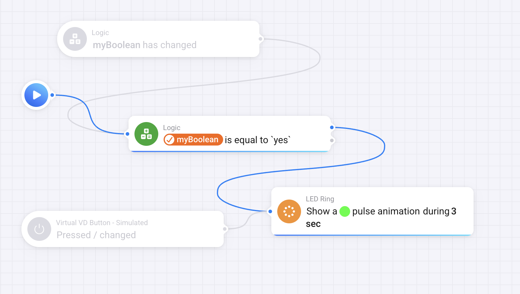

The Advanced Flow variant was developed by community member @Alexander_Jeppsson so I can’t speak to it in detail… and it’s been a while since I originally played with it, but I suspect you may need an explicit ‘Start’ node.
From my previous screenshot, it’s the play button icon. And it’s called ‘Start’ in English in the ‘Add’ menu of Homey Advanced Flows and is just after the first separator line in the menu.

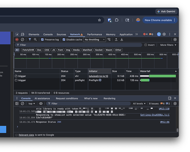

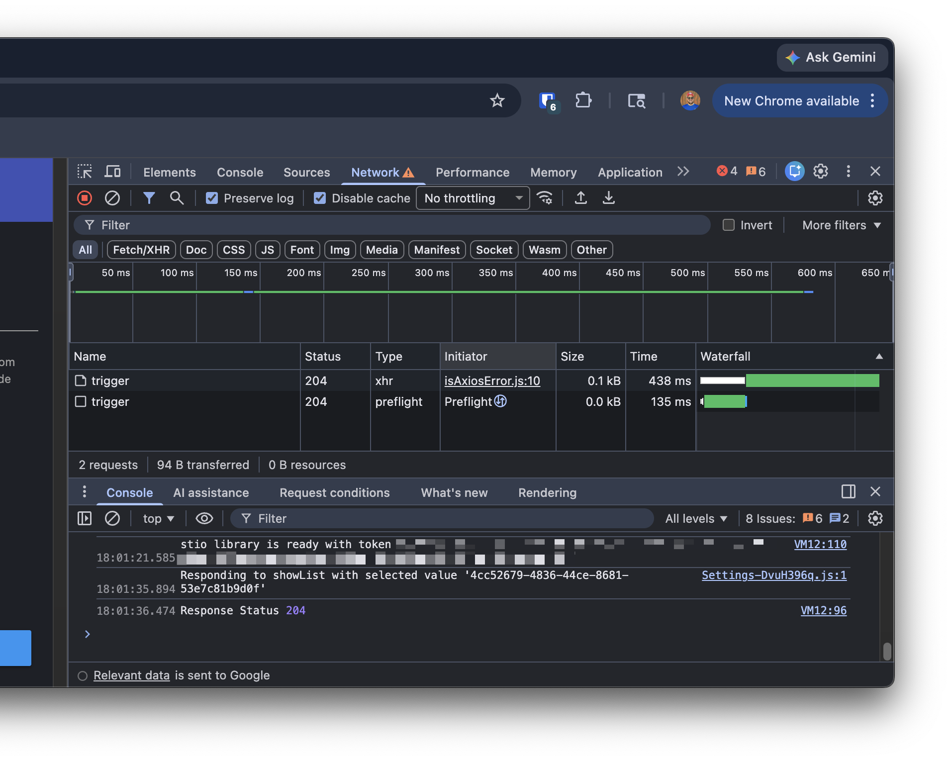

I created a new api key with full access: {REDACTED}
Network log shows I’m getting a 204 (no content) error.
Console log shows a 401 unauthorized error.

A 204 is normal and indicates success (the Homey server didn’t need to include a response body)
The logs you shared show that it’s triggering the advanced flow as expected, so i would check the other items I mentioned around configuring the Advanced Flow with an appropriate Start node connected into the flow.
PS. You mentioned a 401 but it wasn’t clear what the request was for. The logs clearly show the selected flow being triggered though, so it’s pointing toward the configuration of the flow itself.
