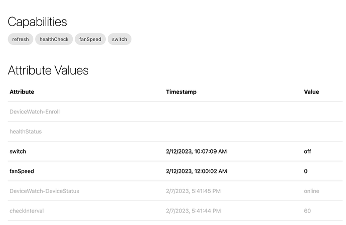

I have an air purifier than has four fan ‘speeds,’ Low, Med and High come through as 1, 2 and 3 respectively. Night mode (a very low fan speed) is a value of 0. When the device is on and in night mode the switch attribute is on and fanSpeed is 0 which is what I expect but the dashboard tile shows off.
I can put in a custom fan speed of 0 and have it show Night but in this case the tile animates and shows Night even if switch is off. And when it is actually in Night mode (switch is on) the tile shows the inactive style (presumably driven by the 0 fanSpeed, not switch). Hope that makes sense.
How can I have the tile show active/icon animate only when switch is actually on? Maybe through styles? I can’t figure it out if so.

What capabilities is the Thing you are controlling reporting?
I would have to go back and double check, but I believe that if the device has the switch capability, then the macro for toggle should show up in the Super Tile action editor (unless it has its own native ‘toggle’ command).
It has switch and fanSpeed capabilities but toggle does not show up.
Thanks for sharing. Now that you shared the screenshots, I recall that the Toggle macro might require that the ‘switch’ capability is the Hero Capability in order for the toggle to show up. I can take a look when I’m back in the office as there’s probably not a strong reason to require it being the ‘hero’ capability rather than just supporting that capability at all.
