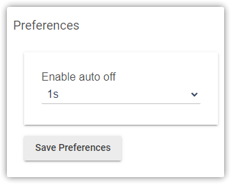

Note that after creating the virtual switch in Hubitat, you can update its preferences in the deviceâs details screen to automatically turn off. Thatâs particularly helpful for an automation like this where you want to trigger things based on the switch turning to âonâ, so you need it reset to âoffâ each time.
