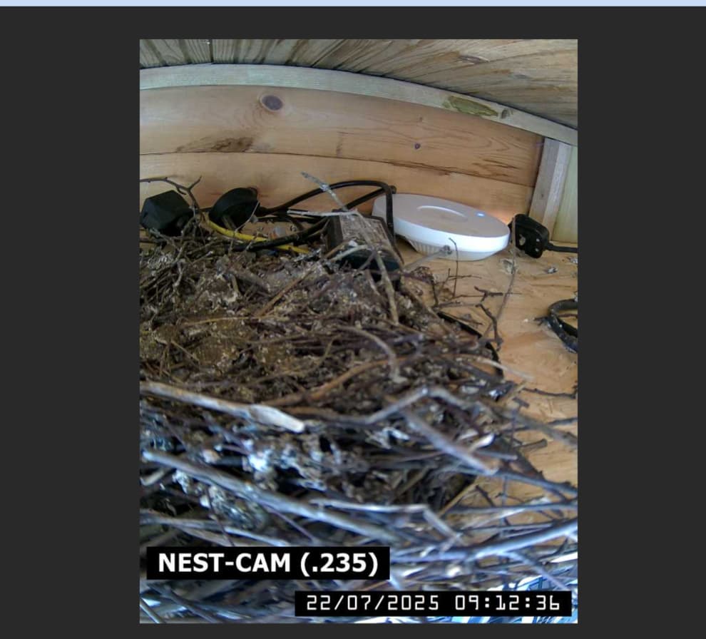

Each of these cams are displayed live. Clicking on one then shows the cam fullscreen, which is perfect for my needs, eg

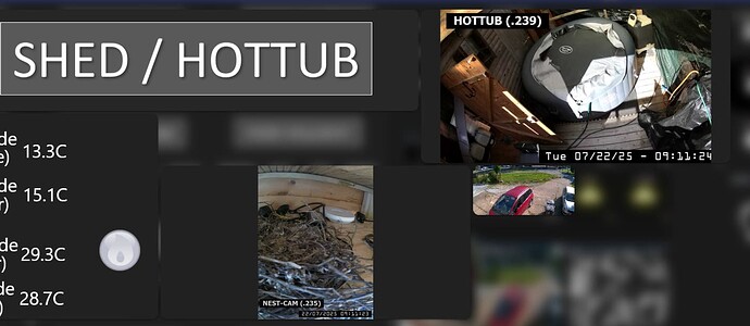

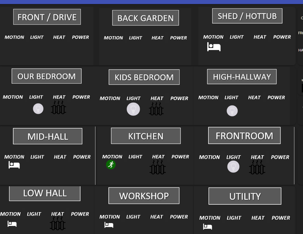

Here’s the tile layout:
Summary

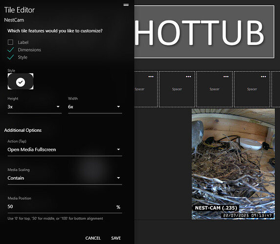

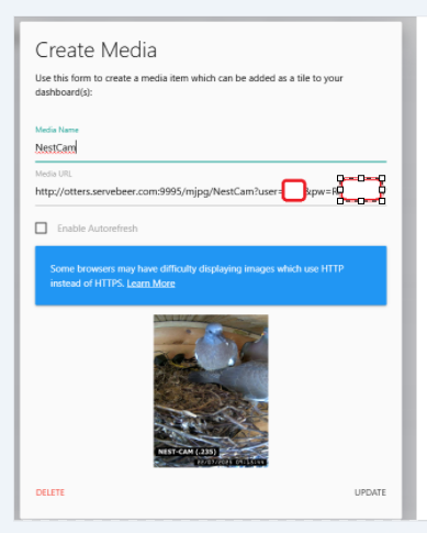

And here’s the details for the actual media tile:
Summary
Is is possible to hear the audio? Works fine directly through BI interface, but doesn’t translate through sharptools, which is currently live video only.
Cheers !
The Media Tile integration is more of a static or streaming image type of integration. MJPEG, the streaming format used as shown in your final screenshot, is basically just streaming a series of JPEG still images as video, so it fundamentally doesn’t include audio.

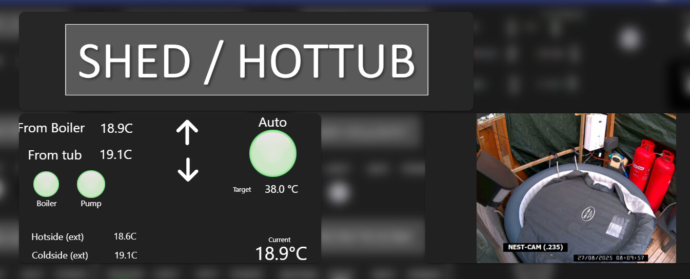

Righto, this is how I have this setup, which works well for my usage.

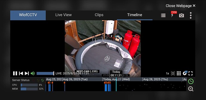

Basically, I’ve avoided using the media tile.jpg route so I can see live footage in a small tile, without the load on the server. Plus (more importantly), I can click it to see a large version, which clicking again takes me to a full ui3 view.
i.e
Main dash:
Summary
Overlay link to sub dash:
Summary
…which is this…
Summary

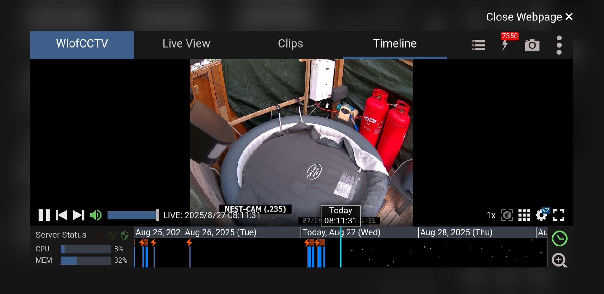

Clicking the feed image takes you to this:
Summary

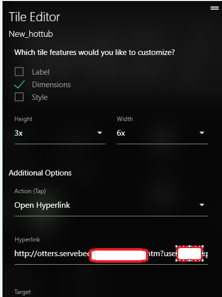

…using this…
The target is as follows:
hxxp://otters.servexxx.com:9xxx/ui3.htm?user=xxxx&pw=xxxx&t=timeline&cam=NestCam&maximise=1
From my limited testing, works fine using fully kiosk.

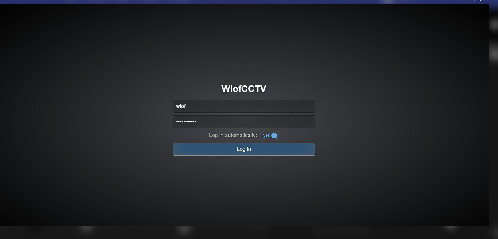

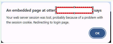

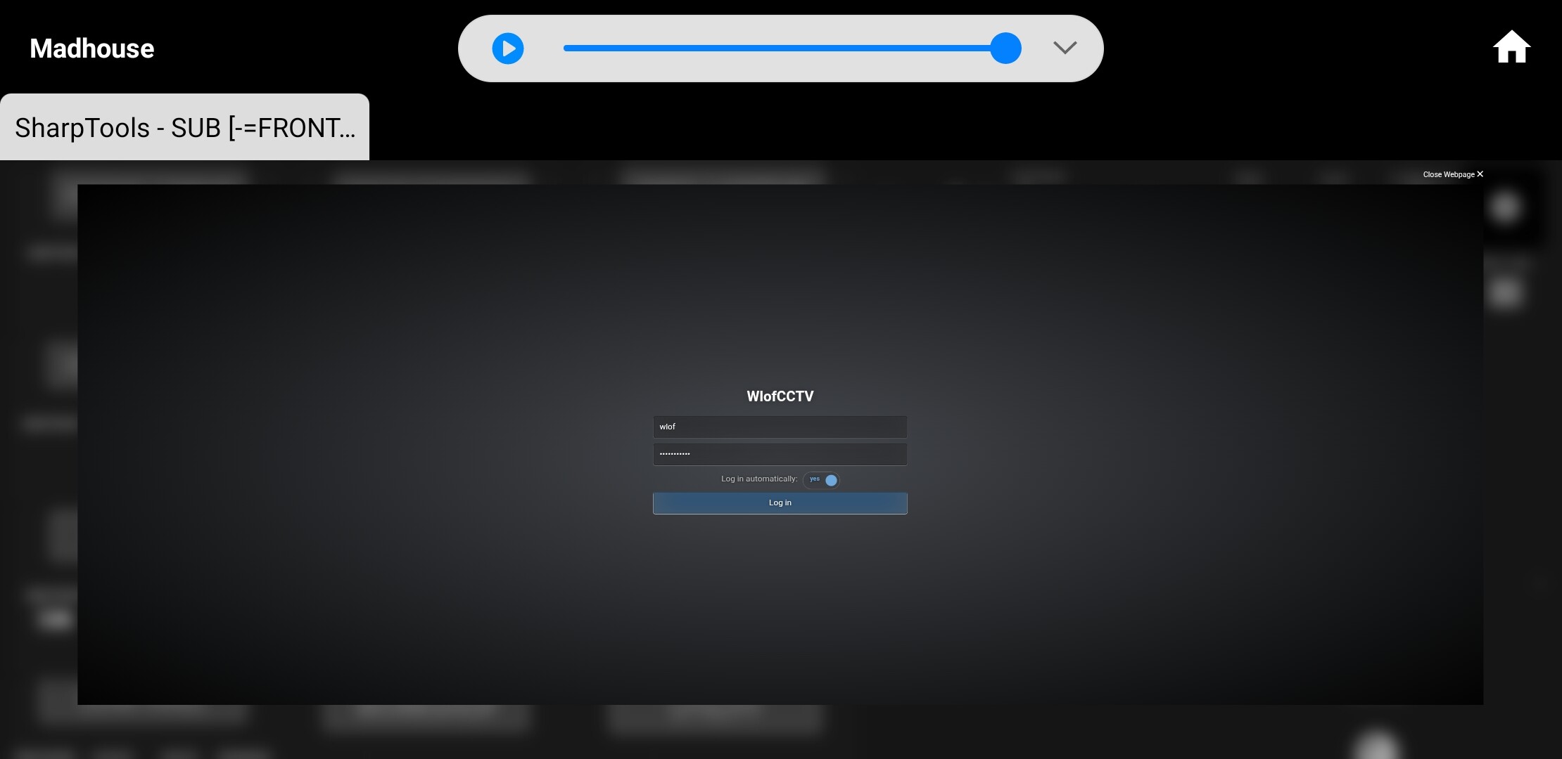

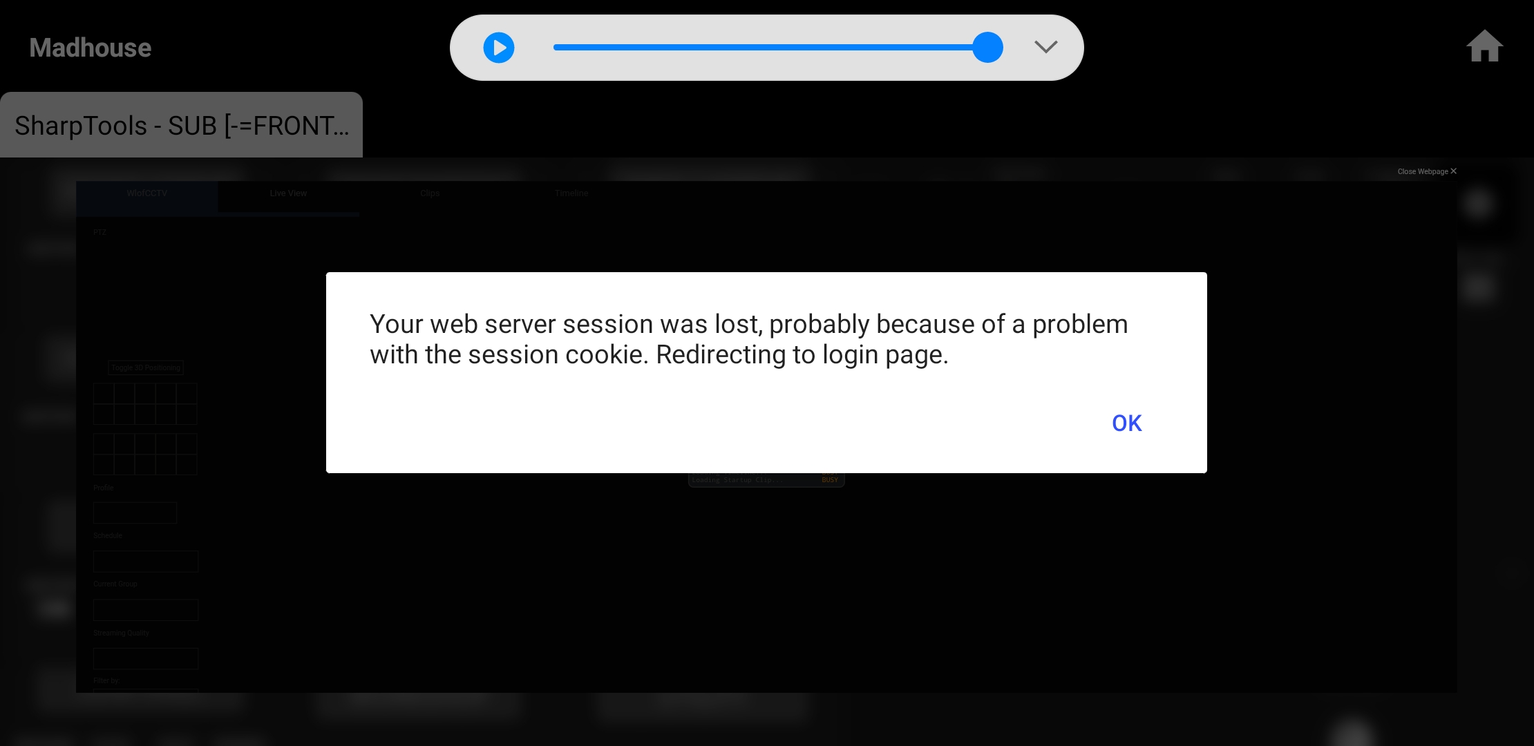

Having a niggling issue.
Something to do with the session cookie. I then need to log in on a standard non-modal page. Once I’ve done this again, it’s fine again for days.
Any ideas on how to avoid this?
@josh ?
This was in Fully Kiosk Browser, right? Have you dug through the settings to see if there’s anything related to sessions / cookies that might need to be tweaked?
I’ve messed about for hours.
Nothing I can see.
