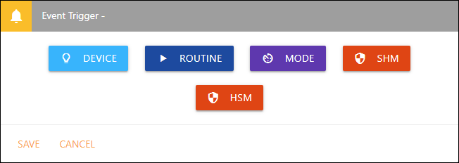

Rules are always run based on Triggers which are instantaneous events like a device changing state or time ticking over to a particular time.
As shown in the screenshot above, Triggers can either be Event based or Time based - either way, those are instantaneous events that cause the trigger to be evaluated. If the trigger condition is met, the rule is run.
Note that Event Triggers are always OR’ed together. Meaning that when any of the triggers become active, the rule will be run.
Event Triggers
Event based triggers include the following options:
As you might infer from the name, these type of triggers occur based on events in the home. With events being the instantaneous moment that the state of the thing, mode, or alarm status changes to meet the specified condition. (This is different than If Conditions that we’ll talk about later that are based on checking what the current state is)
  • Device
    • When you select a Device based trigger, you’ll then be prompted to select the Device, Attribute, Operator, and Value.
