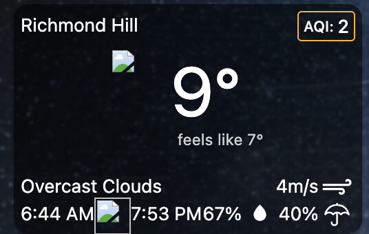

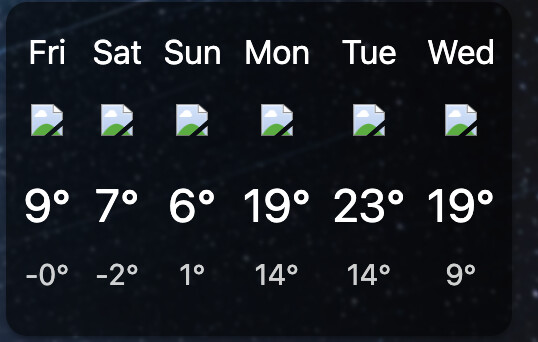

Today, I’ve noticed that all the icons are broken in my Weather Custom Tile. I did do an update from source to the latest version of 2025-12-22, but still with no luck.
I checked on Hubitat, and the info seems to be accurate, but just the icons. Is anyone else experiencing this issue today? TIA
The latest version from source should have been 2026-02-06 (per the comment header at the top of the code) which fixed the chart compatibility with really old devices like iOS 10.x
I just pushed 2026-04-09 which fixes the URL for the icons.

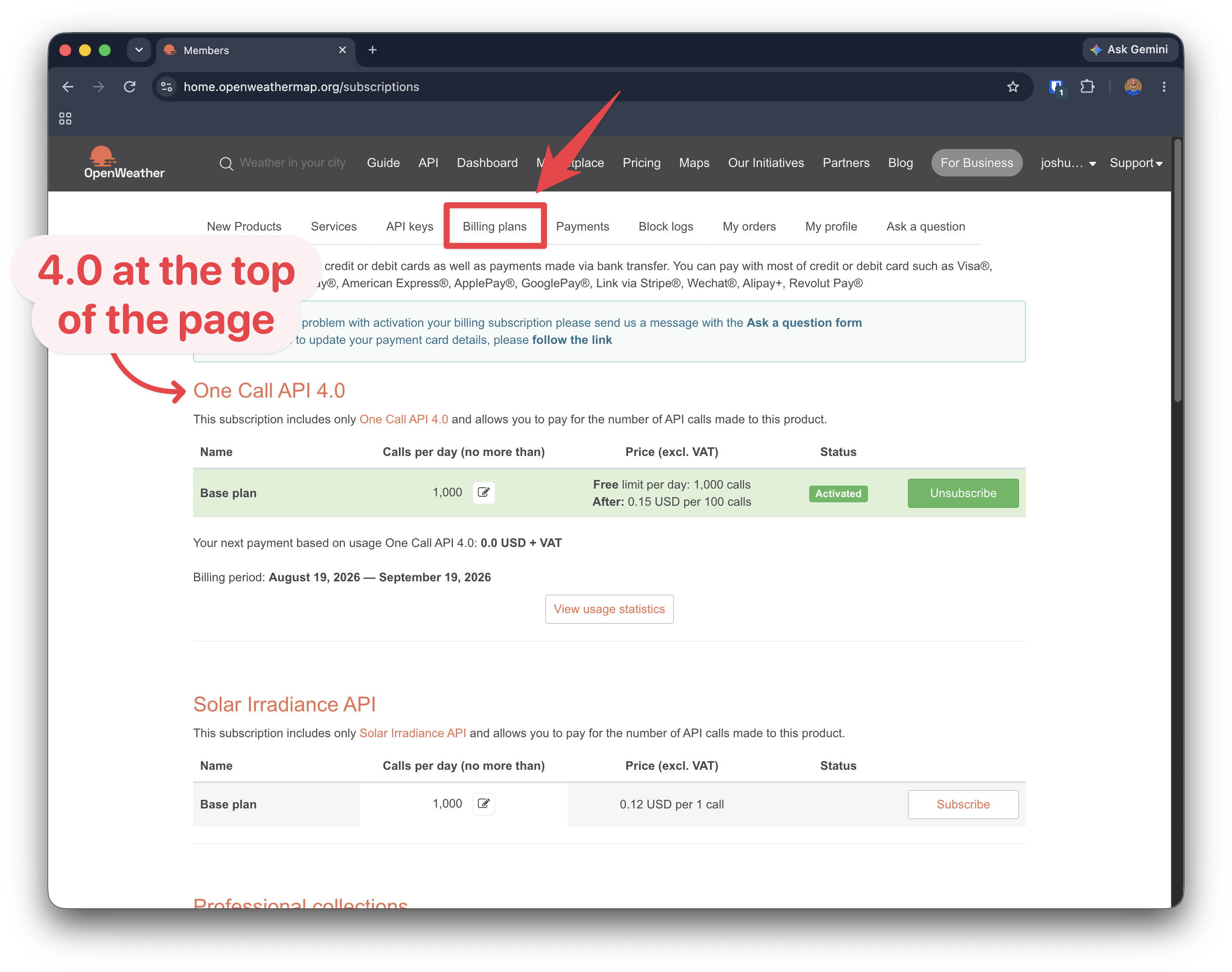

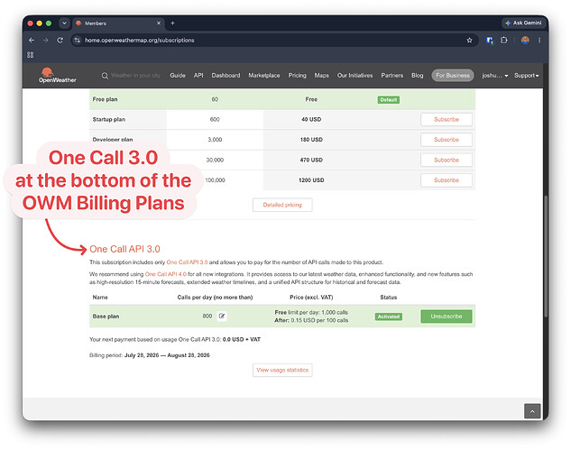

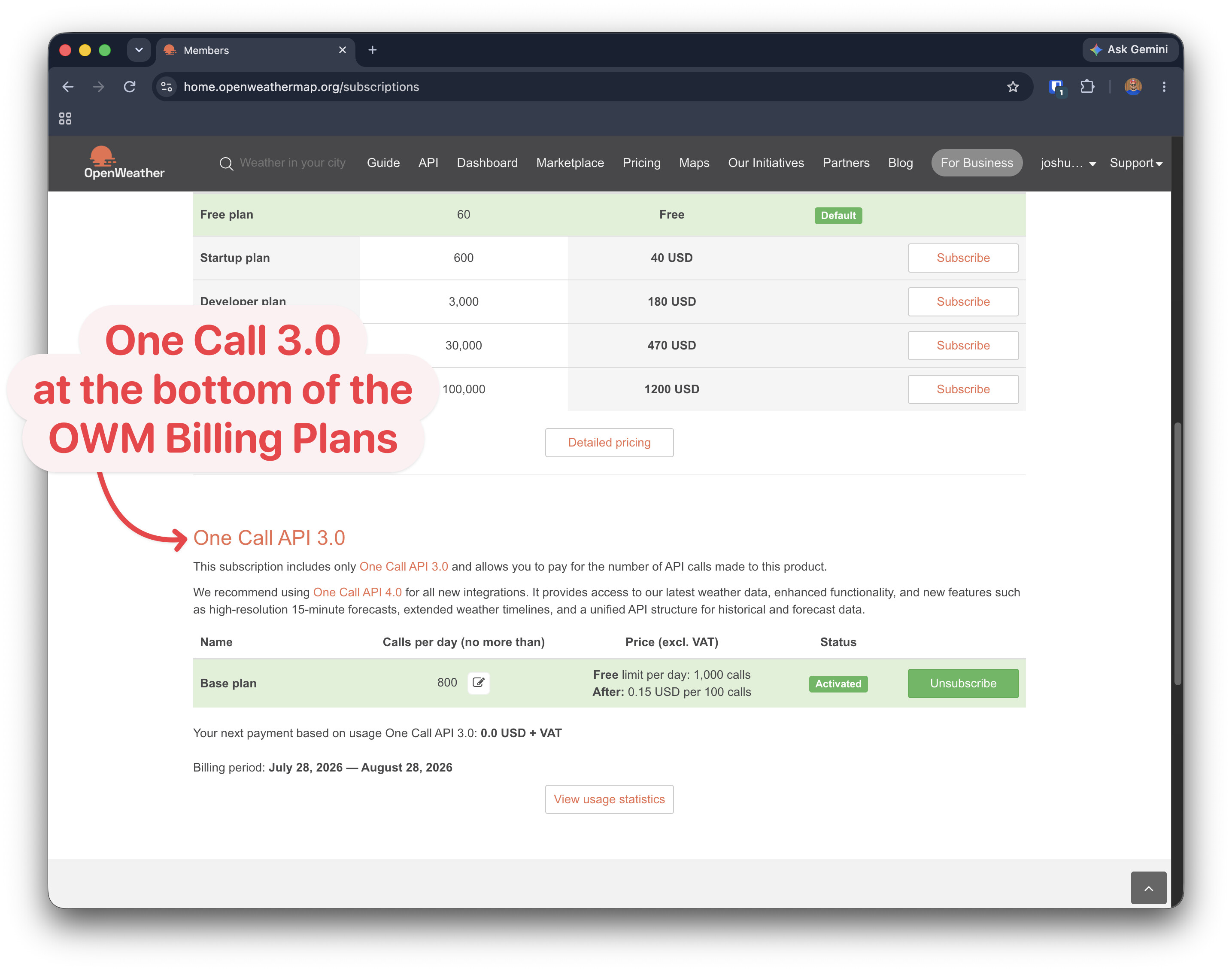

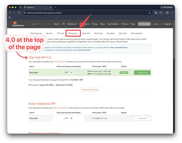

The OpenWeather 3.0 to 4.0 documentation implies that One Call 3.0 should still be available. That being said, the setting to enable it was at the very bottom of the ‘Billing Plans’ section of my account whereas 4.0 was the very first thing on that page, so you may need to scroll down.
One Call 3.0 remains available today and isn’t being switched off as part of this release. We recommend 4.0 for all new integrations, and this guide is here to help existing 3.0 customers move over at their own pace.
That being said, I went ahead and updated the tile to support the new One Call 4.0 API format. As usual, you would need to update your custom tile to pull in the latest updates.

Thanks for the reply. I just checked the website again and cant find anywhere that will allow me to subscribe to the 3.0 so if you are able to find it could you possibly send me a link or a screenshot of where it’s located? Thanks again for the help.
When I’m logged into my account, One Call 4.0 shows at the top of the page and if I scroll all the way to the bottom I see One Call 3.0.

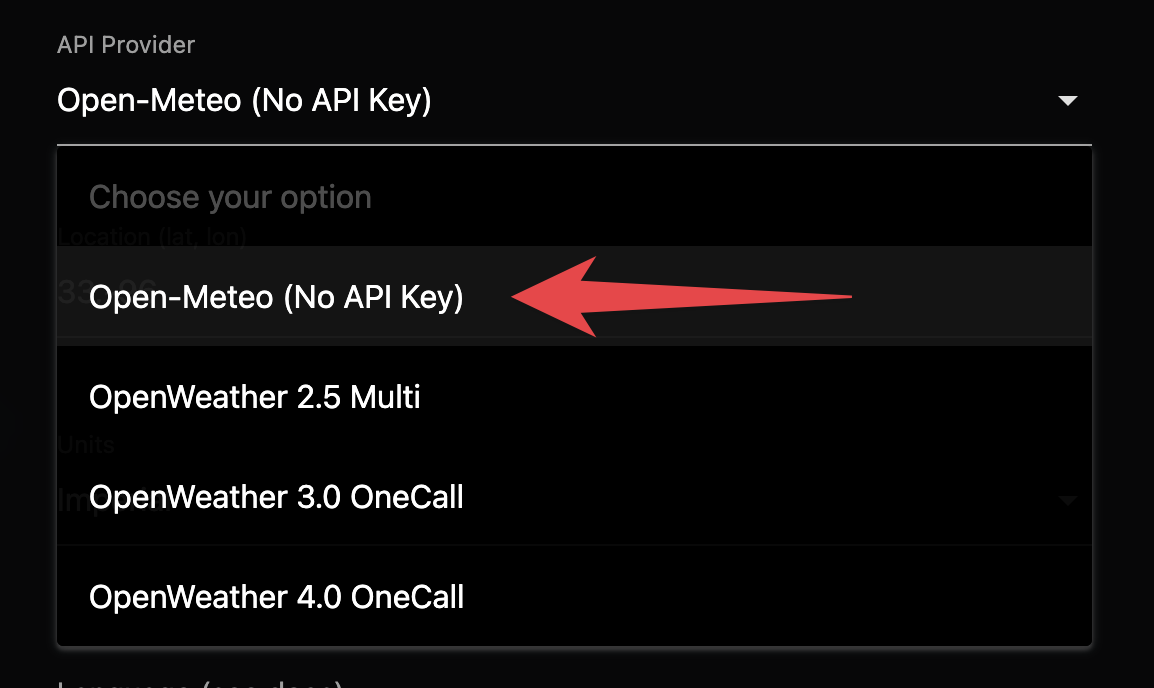

That being said, is there a particular reason you have a preference toward using a Open Weather Map provider rather than using Open-Meteo which doesn’t require an API key?
I would also note that once I activated One Call 4.0 (subscribed in OWM), existing API Keys that I had created previously started working with the One Call 4.0 API. So it’s not like you have to create a special API key for one API or the other… you just need to be subscribed to that API so that particular API version is activated.
I tried using the one that doesnt request an API Key and the temps are not close to being accurate and I put the correct longitude and latitude in. I created a second tile and tried using the Open Weather 2.5 and thats a little more accurate but still a ways off so was hoping if I possibly used the 3.0 that it may be a little more accurate. I also have the refresh rate set to 10 minutes. Thanks again
