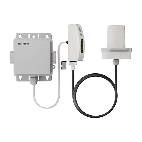

This is new from Ecowitt using a laser for water depth.
I hadn’t seen that before - thanks for sharing.
