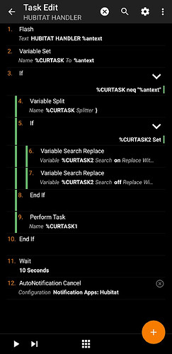

Absolutely and you don’t even need SharpTools. Set up a rule on your hub, such as Hubitat which is what I use. When your camera detects motion, trigger a notification on your tablet from Hubitat that then triggers Tasker. Within tasker, just use the AutoTools AutoInput plug in with a single tap on your screen to wake it up.

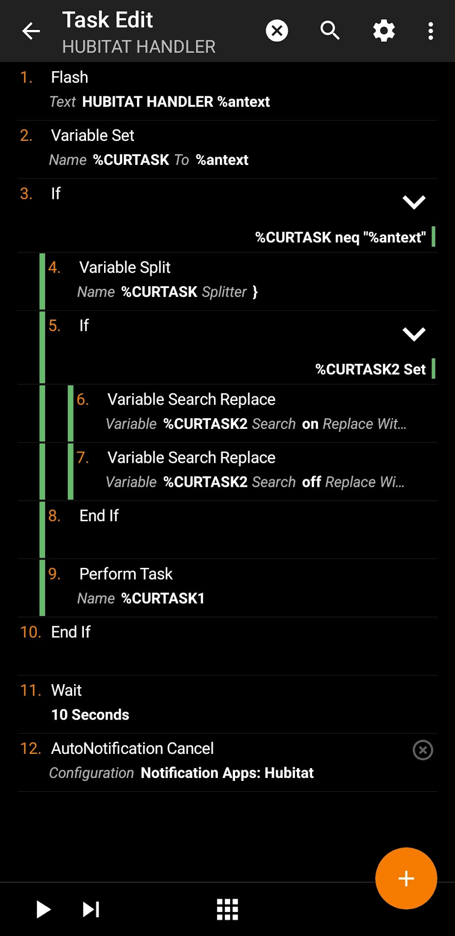

On Tasker, I have a profile set up that triggers anytime there is a Hubitat notification (via AutoNotification). Then it triggers this task (HUBITAT HANDLER) to make Tasker do whatever you want in response to the notification:
So for example if you wanted your camera to trigger Tasker to run a task like “Wake Up Tablet” with that single tap from AutoInput, you would have Hubitat send the notification of “Wake Up Tablet” and it would trigger the task.
You can also pass as many parameters as you want to Tasker using a single notification and that handler. As an example, I wrote a program to automate door locks and welcome messages, etc. for all of my Airbnb guests. When I put a guest into the system, Hubitat sets door codes, displays a welcome message on the tablet of the guest’s room, alerts me when the guest checks in, etc.
To make all that happen, Hubitat has to communicate with my phone so that I have the guest’s name and phone number. So when Hubitat gets all of that information from my program, Hubitat then sends a single notification to my phone that triggers 1) the task within Tasker that processes all the information (called “GuestMachine”), 2) the specific unit the guest is staying in, 3) a specific command within GuestMachine (in this case “5” which tells GuestMachine to store the guest’s name and phone number of two separate variables, and then 4) actually passes the name and the phone number.
The single notification that Hubitat would send as an example when Greg is checking into Gladstone building, room 320 would be “Gstone GuestMachine}320}5}Greg}555-555-1212”
