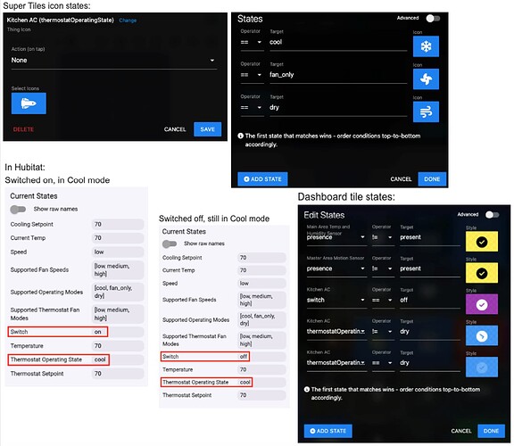

Thanks for sharing the example use cases and screenshots!
As a workaround, you could create SharpTools rule that would combine the two states into a variable, then you could use that variable for the icon.
Example Rules
One approach would be to have a trigger for each attribute changing, then in the rule you could use an expression to combine the states.
