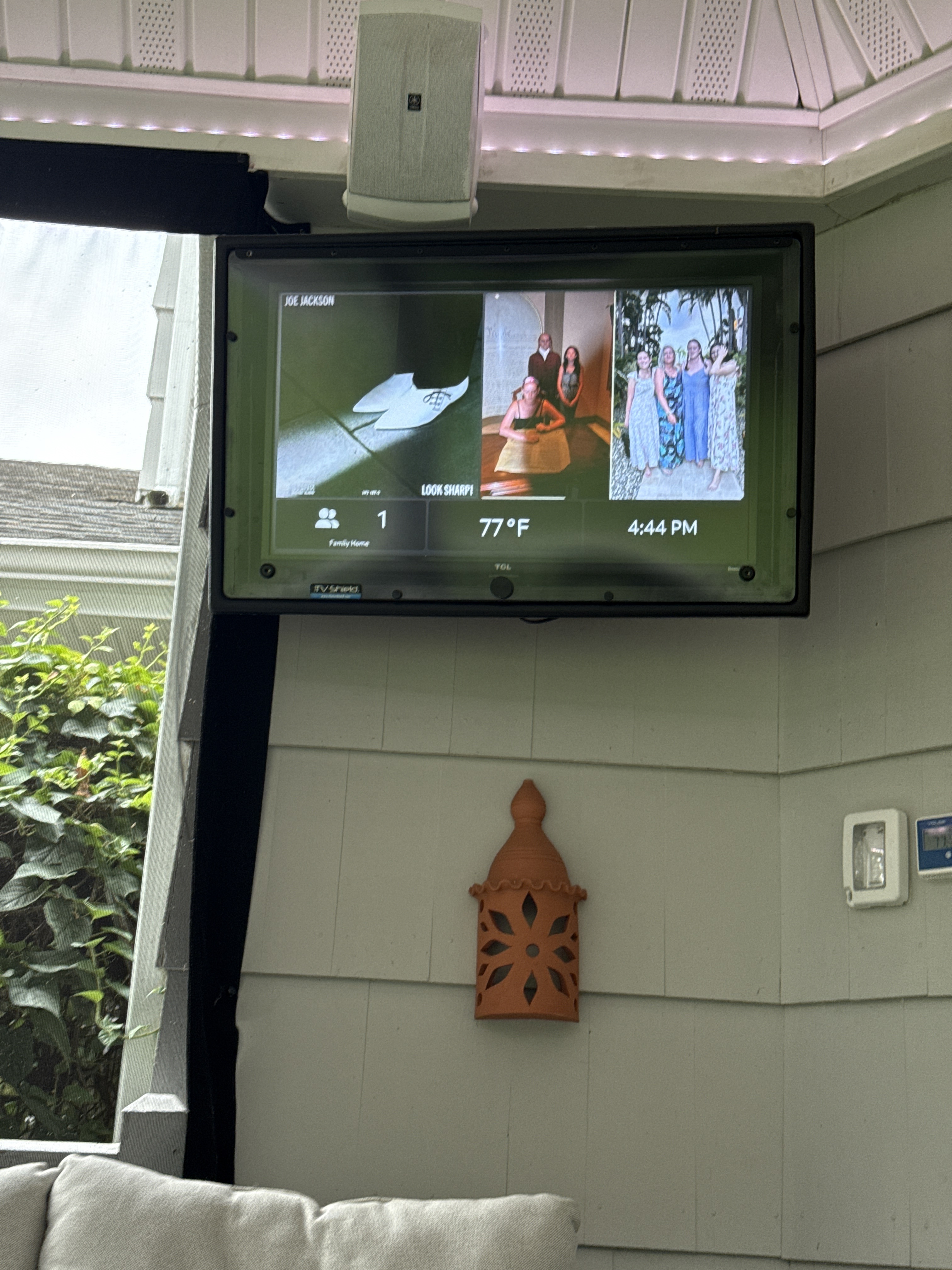

I went down the PI route. I have it setup on my test bench and plan to install in small ventilated enclosure. My TV is in a gazebo and completely protected from the elements. I used a 4b. Not the greatest performance but for general feedback and think it will work well. Will follow up once installed.
Working nicely. Threw together a quick dashboard for testing. The Roku TV is automated so it comes on when we are on the porch.
Looks great! Thanks for sharing.
