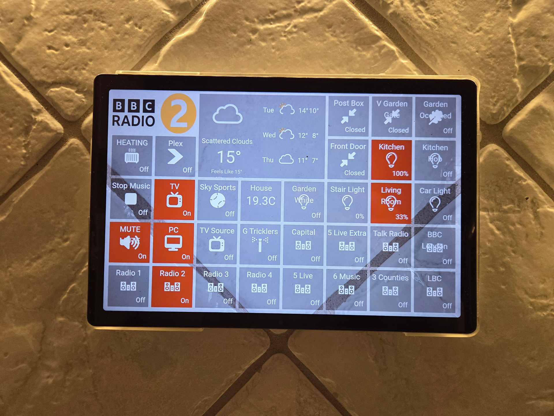

While you’re there, I’m trying to get the background image to stay still, because if i have more tiles than the screen holds, the background image scrolls too. I want the background image to stay still, seems pretty basic behaviour but i’m having a tough time trying to get it to work. chatgpt doesnt know either..

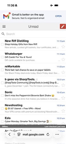

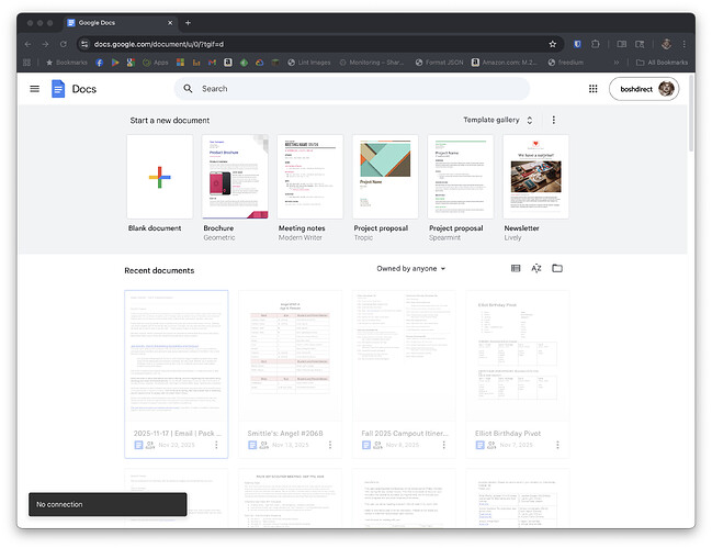

I understand the frustration, but there’s a lot of nuance being missed here. SharpTools uses a realtime connection that the vast majority of websites on the internet don’t use.
For the vast majority of the internet, when you load the website the page/content is delivered to your browser all at once. Those sites don’t have realtime status pushed down to your browser as one of their core functionalities. For example, if CNN updates the article, you have to manually refresh the page to see the edits.
SharpTools on the other hand is less like a website and more like a web app where realtime status is a critical part of the design. Many web apps which have realtime status as a core part of their experience or even just as an enrichment do include connectivity status indicators.
