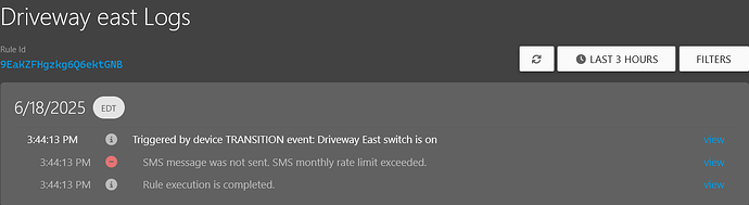

Same issue as recent past: “The SMS messages I have formatted in my Rules are not being sent after 5/15/'25 approx. 10AM EST.” However, this time no messages after 6/12/'25 @ 11:58AM.
I tried the approach that may have resolved the issue in the prior instance. Sending “Text Test” to Verizon SMS.
This did not resolve the problem.
Any suggestions?
What do the relevant rule logs look like?
When was a monthly limit imposed? Just wondering. Haven’t seen a notice or a way to increase limit.
A few years ago. It’s not well documented as it was intended as an exceptionally high guardrail at 1000 messages.
To be perfectly transparent, I’ve been meaning to drop it down to a much more reasonable limit. Each SMS sent costs $0.011+, so 1000 messages is north of $11. With subscriptions at $3 or less a month you can see how it isn’t sustainable. :slight_smile:
I have no problem with paying a nominal fee. So I’m not faulting you. Either set Text Cost at a high level, or on a per-text basis. If you want $11 per month just let me know how to set it up.
Unfortunately, I deleted the texts when they stopped coming in. So I have no reference for how many I had sent out.
I have started getting my messages, again.
