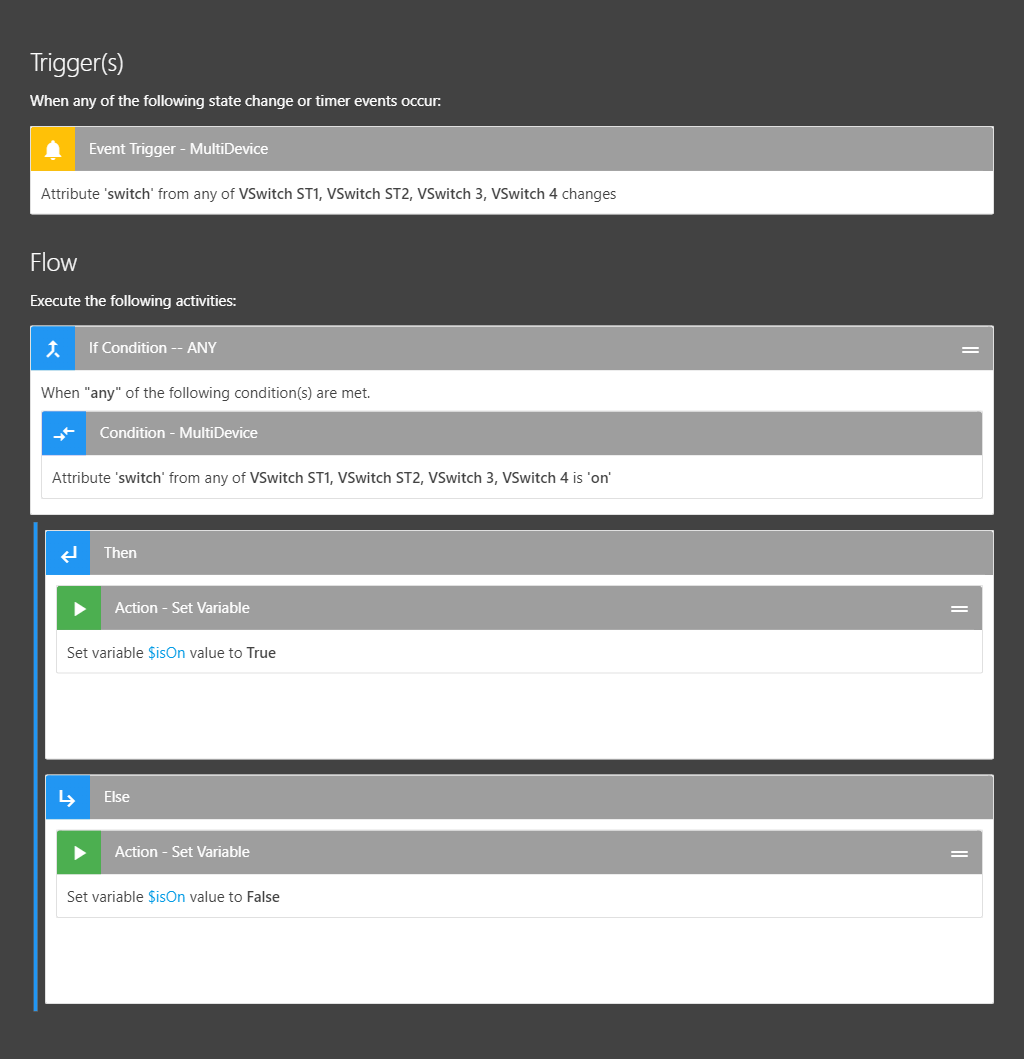

Using SharpTools rules is probably the most flexible. And for your particular use-case, if you primarily just wanted to see if any of the lights within your group was on with the option to click it to see which lights are on, it would be a really good fit.
A rule like the following would trigger when any of the monitored lights change* and then if any of the lights are on, it would set your true/false variable to true… otherwise it would set it to false.
*The generic ‘change’ trigger is available in beta. You could also just use a trigger for when any of the lights change to on and another for when any of the lights change to off for the same effect if you prefer.
Then you could add that Variable to your dashboard and customize it with a light icon and change the background color when it’s “on” (true). And you could configure the click action on the tile to open another dashboard showing all the lights within that area.

Two things that look off here:
- You would need the trigger to either be:
- The new beta changes trigger (without a ‘on’ or ‘off’ specified)
- Two separate trigger blocks for ‘changes and is on’ and ‘changes and is off’
- The IF Condition would need to be set for any of the lights being on
(I had a bug in my screenshot above where it should ‘all’, so I’ve fixed it to ‘any’)
That being said, if you already have a Virtual Switch which aggregates the status as you want, it would probably be easier to just map that switches status to a variable.
As with most rules, there’s multiple ways you could accomplish this. In this example, I’ve used the beta changes trigger (no target status specified) so the rule is triggered anytime my Virtual Aggregation Switch from SmartThings changes… then in Flow, I’ve used a single action for Set Variable along with an expression that sets the variable to true if the triggering value is ‘on’, otherwise it sets it to false.
