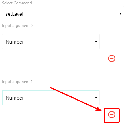

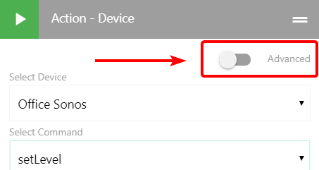

Command Arguments: Advanced
I’d need more detail on what specific device command you’re trying to use or what you’re trying to accomplish. It appears as though the ‘Advanced’ switch in the top-right corner of the device command action has been flipped on.
As you might infer from the name, the ‘Advanced’ switch really is there for advanced use cases. For example, sometimes a device will report back that it has a specific command that accepts a specific number of arguments even though it doesn’t actually accept that many arguments.
For example, many devices report that setLevel accepts two numeric arguments even though the device handler only accepts a single number (the desired level). In that case, you can use the Advanced switch to customize what arguments get sent.
In the following screenshot, you could turn on the ‘Advanced’ switch and then use the remove icon to completely remove the second argument (eg. ‘Argument 1’):
