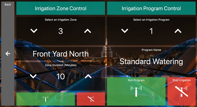

So I’ve got this working. Thanks @josh for the guidance. I moved from creating a device per zone/program to a single controller device that exposes the runZone, runProgram, and stopIrrigation commands. What I was missing was how to use rules/variables for this interaction.
Here’s a screen shot of the first dashboard I worked up (which is very similar to josh’s):
As you can see, I’m using separate tiles to display the zone/program names, which I’m setting in variables via simple custom rules. If it were possible to set these variables ($irrigationZoneName, $irrigationProgramName) as labels, I could remove the dedicated tiles completely, which I would prefer.
Otherwise, I’m happy with the result. Thanks for the help!
