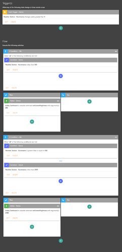

I just checked the Fully DTH, and it does support setScreenBrightness command. Did a quick test in Rule Engine, and it works well. See screenshot below that you can set the brightness from 0 - 255.
How can I translate lux levels to brightness? I’ve looked at the event trigger options and it seems all I can do is set a threshold for it to change to a fixed value. I would need 10 rules for 10 different lux/brightness levels.
I’d suggest to set brightness at 50, 100, 150, 200, 255 values based on the lux value. Adding more brightness tiers probably won’t be much noticeable in my opinions. You can use multiple IF_Conditions in a rule to manage different brightness in just one rule.
See screenshot below for a quick example that I have two IF_Conditions and set different brightness based on different illuminance ranges. (Please note that I didn’t add the 2nd IF_Condition within the 1st IF_Condition’s ELSE path as a nested IF_Condition because it can make the UI harder to read when you have 4,5 levels of nested IF_Conditions.)
