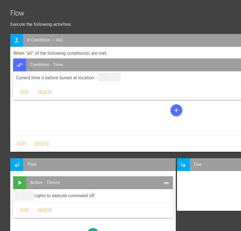

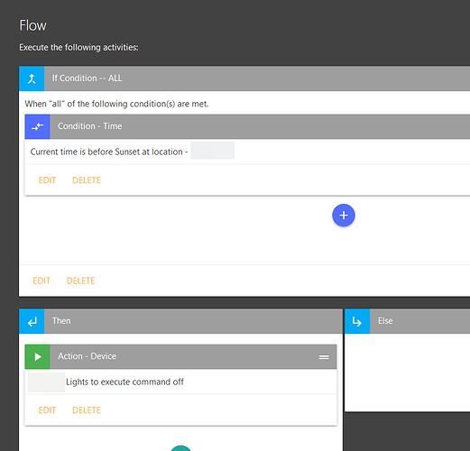

For the illumination measurement, there are motion and multi-sensors that measure illuminance. So using the rule engine, you can turn the lights on when the illuminance changes and goes below a certain value:
Turning back off before sunset if it gets bright would look something like this, although I’m not sure the 15 minute delta to sunset is possible at the present.
