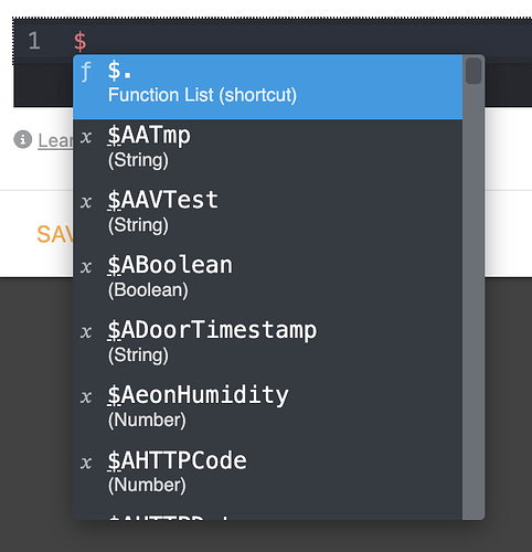

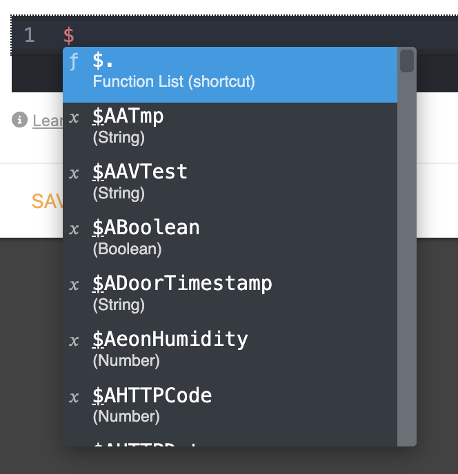

For future reference, the Expression editor has an autocomplete feature. When you start typing $ it will automatically prompt with a list of variables.

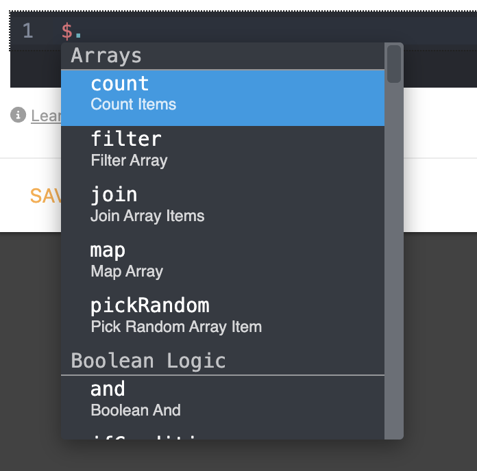

Expression Functions $. side-note (tap to expand)
Not necessarily directly related to your post, but the first item in the list is $. which is a special placeholder to pull up the list of common expression functions.

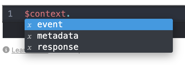

$context.
For the $context variable, once you select it from the list or type the trailing period as $context. it will bring up the next tier of Context Variable groupings:

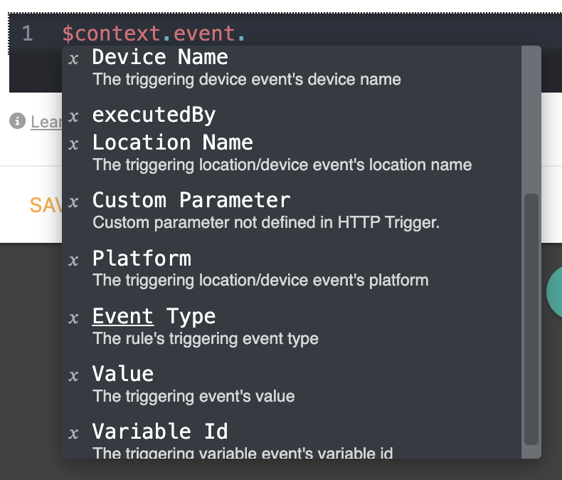

$context.event.
And if you select $context.event. it will bring up the valid options available under that tier where you can select value :
