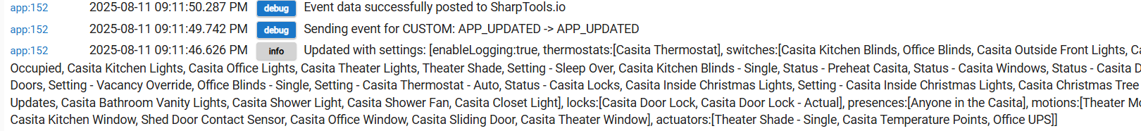

If I go through the app in hubitat to update the devices, the log is as such:
There is no new token sent. It seems to think that there is no problem or need for a new token. Any device updated for this hub is updated successfully on sharptools.
