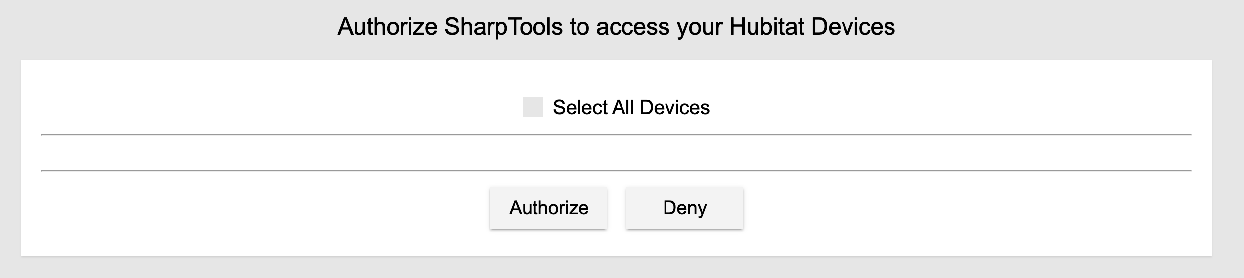

@josh I was making some changes tonight and updating the devices in the Sharptools App in Hubitat and I noticed placeholders showing up so checked from the sharptools side and got this:
Tried it from two different Hubs and it doesn’t appear to be working. Is this an issue with me or something on the hubitat side? Thanks.

Are you also experiencing the issue where the Hubitat (OAuth) Authorization screen is blank where the categories and list of devices with checkboxes should be?
And are you implying that the issue only started occurring after updating to that particular hub software platform version?
I am seeing that the Hubitat OAuth screen is blank on any of my 4 hubs. What I can tell you is that as long as I don’t go into this screen the new devices are showing up in Sharptools. The major issue is that if you don’t back out of the OAuth screen you will find that all devices are removed from the Hubitat Sharptools list and every tile on Sharptools will now be a place holder. If you add all items back into the Sharptools Hubitat list and DON’T go near the OAuth screen, your devices will come back. Had to learn this the hard way. I have a suspicion that this is a Hubitat update problem not a Sharptools issue.

:tada: Hubitat platform version 2.4.2.128 was released and fixes the blank Hubitat OAuth screen issue.
  • I upgraded from 2.4.1.1462.4.2.126 and was then able to reproduce the issue.
  • Hubitat fixed the issue and I upgraded from 2.4.2.1262.4.2.129 and can confirm everything is working again.
