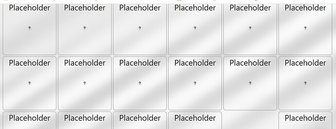

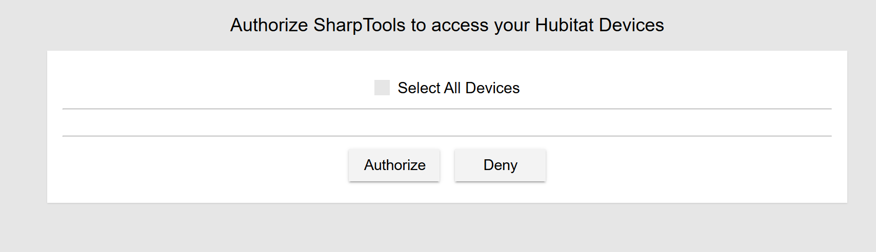

I have a bit of a problem tonight. I added a smart wall switch-went to manage account- did a re-authorization and checked select ALL DEVICES.
All of my devices in SharpTools are now GONE!
I’m trying to re-authorize a Hubitat hub.
All of my devices on my SharpTools dashboard are now placeholders…
Thoughts?
See above. One of the Hubitat hub versions had an authorization bug recently but a fixed version was already released by the Hubitat team.
I thought I was already past that one but I see another update is available. Doing a backup and update now. I’ll let you know what happens.
2.4.2.129 Fixed the problem!

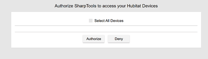

I have tried de/re-authorizing all the devices. I have even tried removing/re-adding the Sharptools app on the Hubitat side. None of that works. Any idea how I can fix this? TIA.

If the devices get deauthorized or if the app gets fully uninstalled, then the associated event subscriptions stored within the “app” will get removed.
On the SharpTools side of things, a healthcheck is kicked off when you reload the page and one of the things that does is try to add back any event subscriptions that SharpTools thinks you should have but are missing from your “app” installation.
