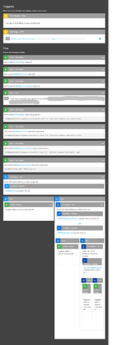

Hello!
Working on refining my irrigagtion system with rain controls through an HTTP call to open weathermap.
The rule fails to change variables, and Claude fails to help ![]()
Any suggestions?

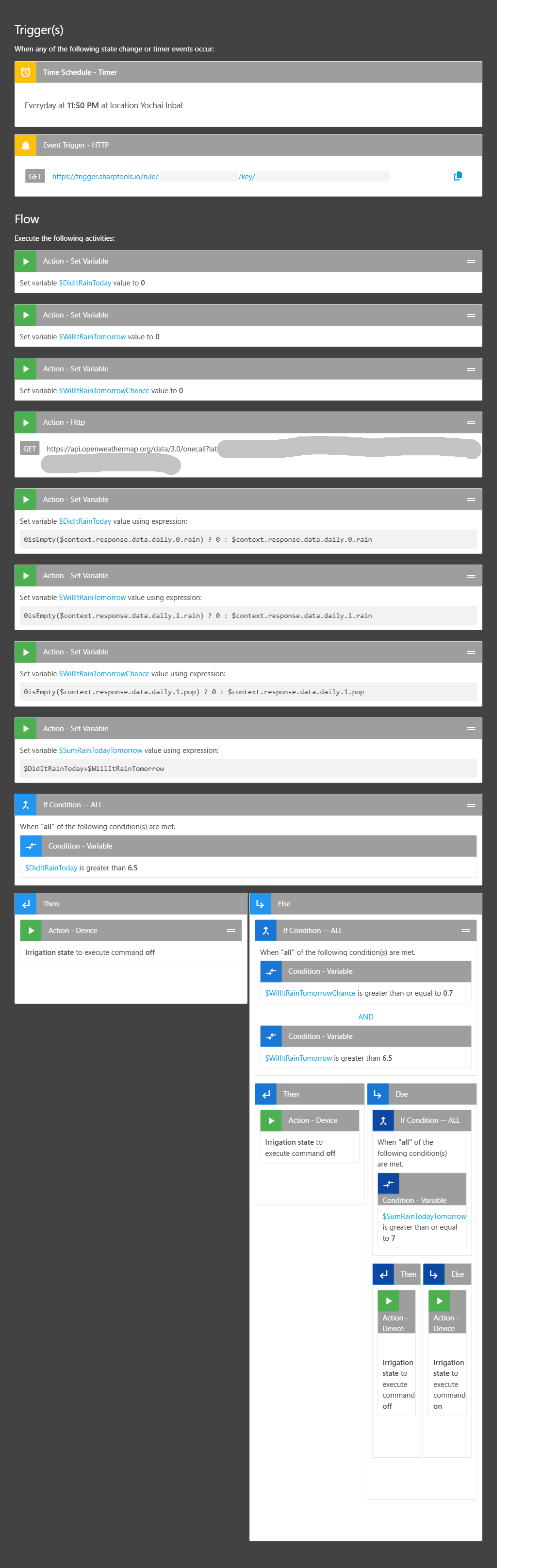

Are you seeing it on a particular step of those rules? Several of the expressions look like they have a leading zero on them which would presumably cause the expression to result in an error.
Thank you, @josh for your human support.
It worked!
