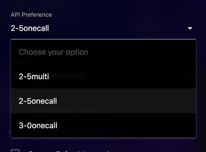

What API configuration are you using with your Open Weather tile? The Open Weather team has been planning the shutdown of their OneCall 2.5 API since early 2024 but it kept getting pushed back. I got an email in March from OpenWeather saying the following:
This is to inform you that One Call API 2.5 support will be closed on March 28, 2025, and any calls to the product after this date will not be successful.
When I tried a newer API Key with the 2-5onecall setting (in the tile settings), I got a pretty clear error:
I decided to just purge it all and start over. It is now working with the latest install.
