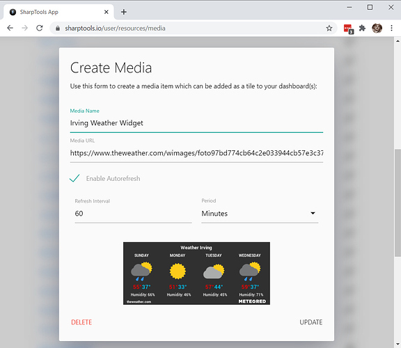

When I use a hyperlink to the accuweather website, Sharptools does not open the hyperlink, it tries to open a dashboard then reports that the dashboard does not exist.
When I use media, I get the picture above. I’d like to just throw an OOTB icon in it. Media open the hyperlink properly, but is ugly on the dashboard because I can’t edit what it shows.
Thanks for sharing the screenshot! It looks like the Hyperlink resource has the Name and the URL swapped. The part where you have part of the URL scribbled out in your screenshot is the ‘Name’ field from the Hyperlink resource.
You can edit your existing Hyperlink resources here: SharpTools App
The Media Tile is designed to show media from a URL - for example, a network camera stream or a weather image. You can find more details on that in the following article, but it sounds like the normal Hyperlink Tile is what you are looking for:
