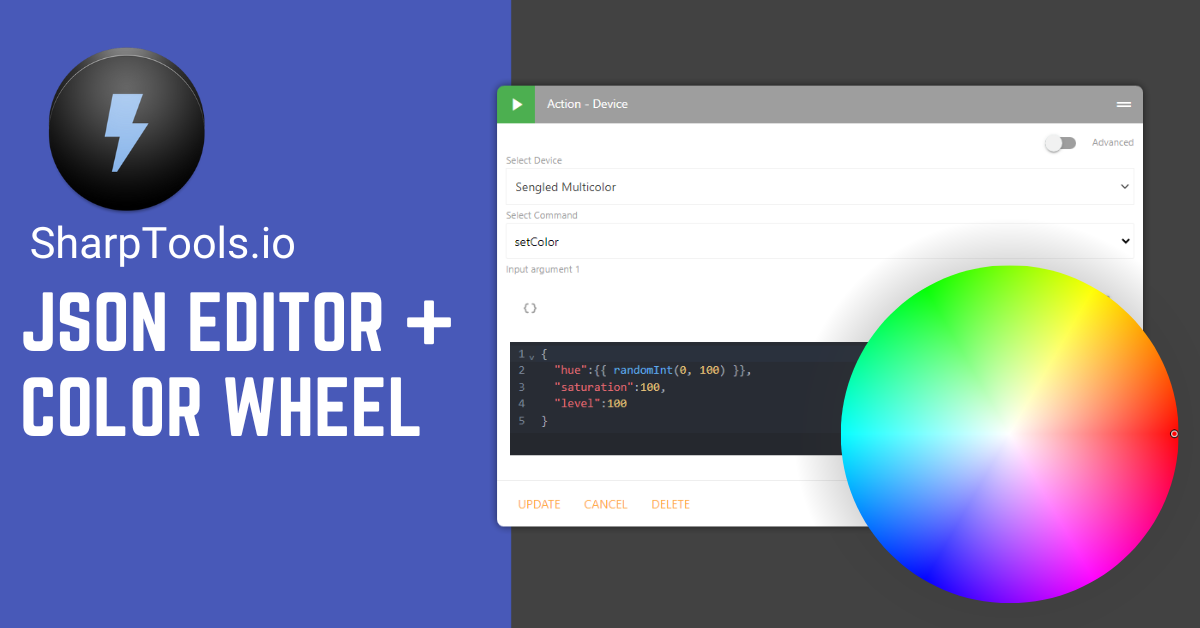

The new JSON editor is built upon the base editor used in expressions (and in the Custom Tiles editor). The new editor is available when editing JSON arguments of a device command as well as HTTP Actions and includes a number of neat features:
  • Syntax highlighting and automatic bracket matching
  • Syntax validation with error indicators
  • Ability to use inline expressions within JSON :exploding_head:
  • Support for the newer JSON5 standard (incl. comments in JSON)
:light_bulb: As a reminder, you can switch between the Color Map and JSON data types in device commands by flipping the ‘Advanced’ toggle in the top-right corner of a device action on, then tap the icon to the left of the argument to select a new type.
This update also includes an enhancement where the existing value is retained when switching between Color Map and JSON data types (when possible).

For example, you could use the setColor() command to display a random color by changing the hue:
  "hue": {{ randomInt(0,100) }}, //numeric, so we don't use quotes
  "saturation": 100,
  "level": 100

Color Picker
While working on the new JSON Editor experience, we found ourselves frequently using the setColor() command as an example, so we updated the color picker to use the color wheel that’s available on dashboards.
