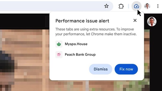

These started popping up on my dashboards a couple of weeks ago. Apparently it is a new feature in Chrome. It is not clear what triggers this is other than “it meets the threshold”. I disabled them in Settings for now. I haven’t noticed any issues so far.
Can you share a screenshot of what you’re referring to?
Not any more because I turned it off in settings in chrome. But like this. Since I only run sharptools on these screens it of course refers to Sharptools. I do feature feeds from webrtc from Frigate for certain cameras on the main screens that run most of the time. Don’t know if that is the issue?
I found my problem. I am using hass.agent to control the touchscreens and change screens at certain points. It seems when use the URL option to bring up a different dashboard it is starting a new copy of Chrome. So after a while it is creating many copies of Chrome and eventually starts to slow and then complains.
