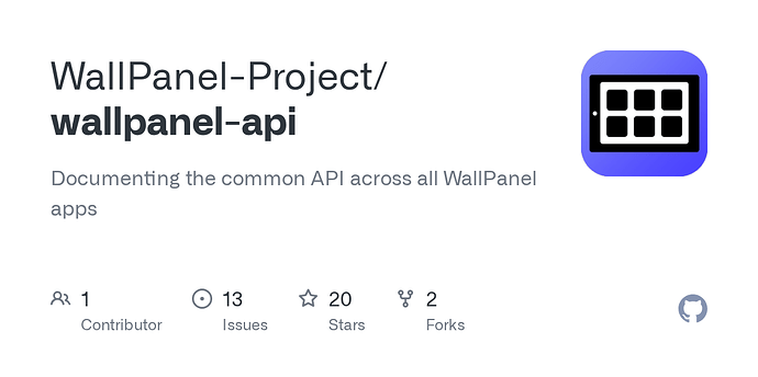

WallPanel has a REST interface so you might be able to use that to automate turning the screen on and off:
I didn’t see an option for turning a screensaver on/off with WallPanel which is a common workaround for Fire Tablets. Another app that is popular for displaying dashboards is Fully Kiosk Browser which has a robust REST API. You can see more details about automating turning the screensaver in Fully Kiosk Browser on/off in the following thread:
