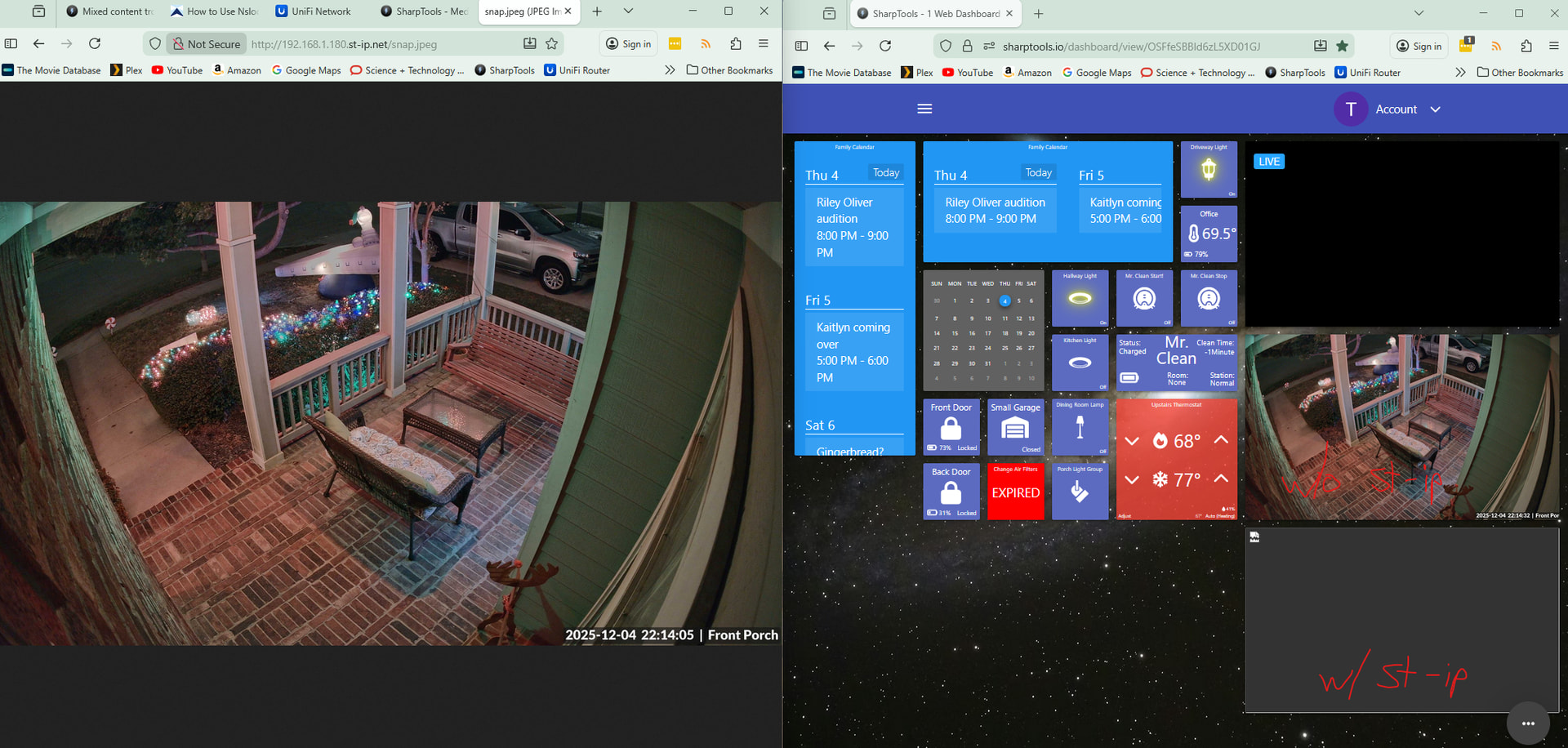

If it were a DNS issue, wouldn’t we expect it to always fail on that client? Here I’ve got two firefox windows open. On the left I’m looking at the camera URL (using st-ip) and it works fine. But in a test dashboard it doesn’t - you can see the tile without st-ip works but the one with it doesn’t.
Not if it’s a Mixed Content issue (HTTP image in HTTPS site) rather than a domain / network resolution issue.
The big browsers seem to be tweaking their approach to this a lot over the recent years. I haven’t tested Firefox recently but Chrome just reintroduced special support for local IPs and it prompts you to give local network access.
So it’s possible Firefox is making a special exception for the local IP and allowing the mixed content, but it’s seeing st-ip.net as a public domain and not allowing an exception for mixed content by default. Chrome allows explicitly allowing mixed content for a domain, but I’m not sure if Firefox has a similar setting.
