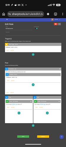

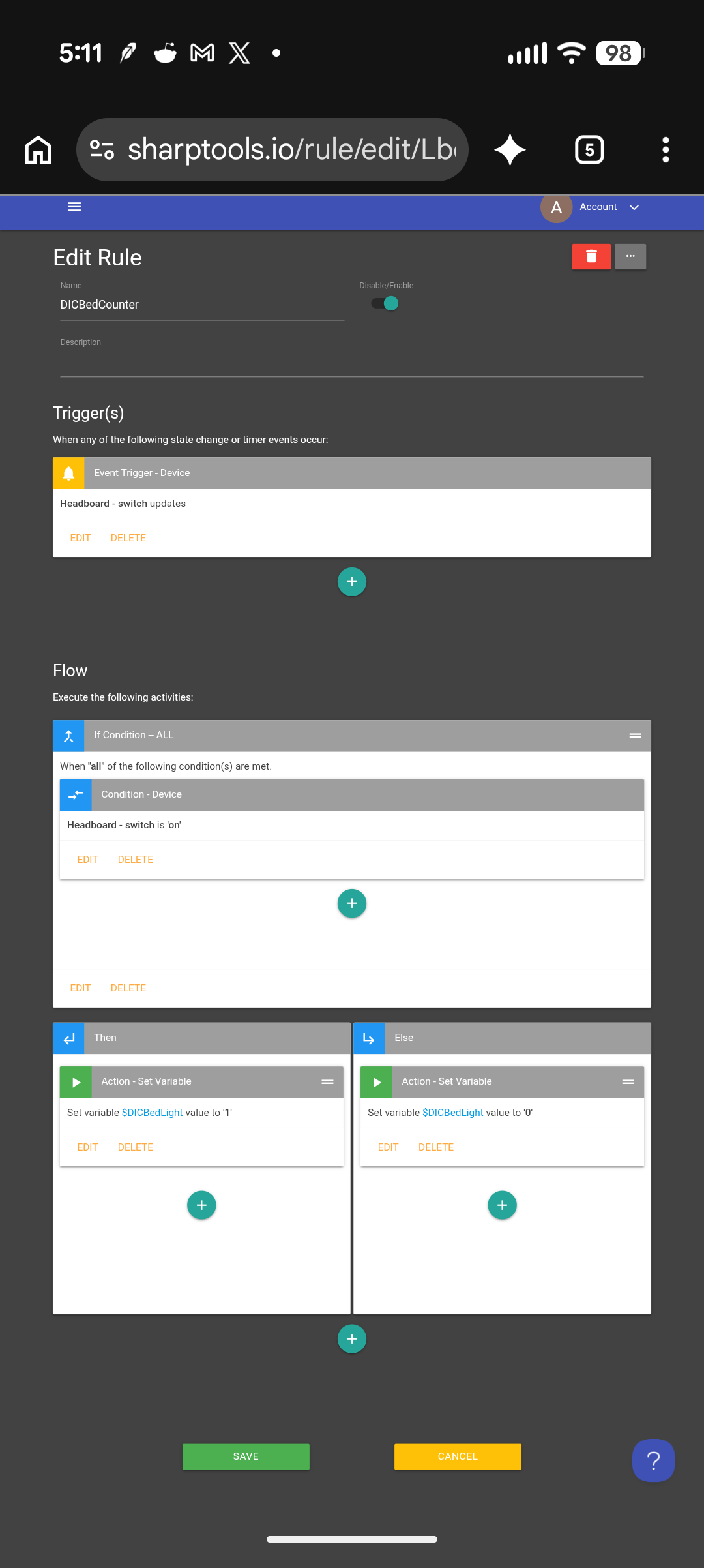

It’s variables occasionally not updating. For instance if a light turns on its 1 if off 0, occasionally it will hang on 1, breaking other things. This is what I see more often.
This is still an occasional thing. I tried changing else statements, did not help. Occasionally the variables just don’t update. Various ones. String, numerical. Etc.

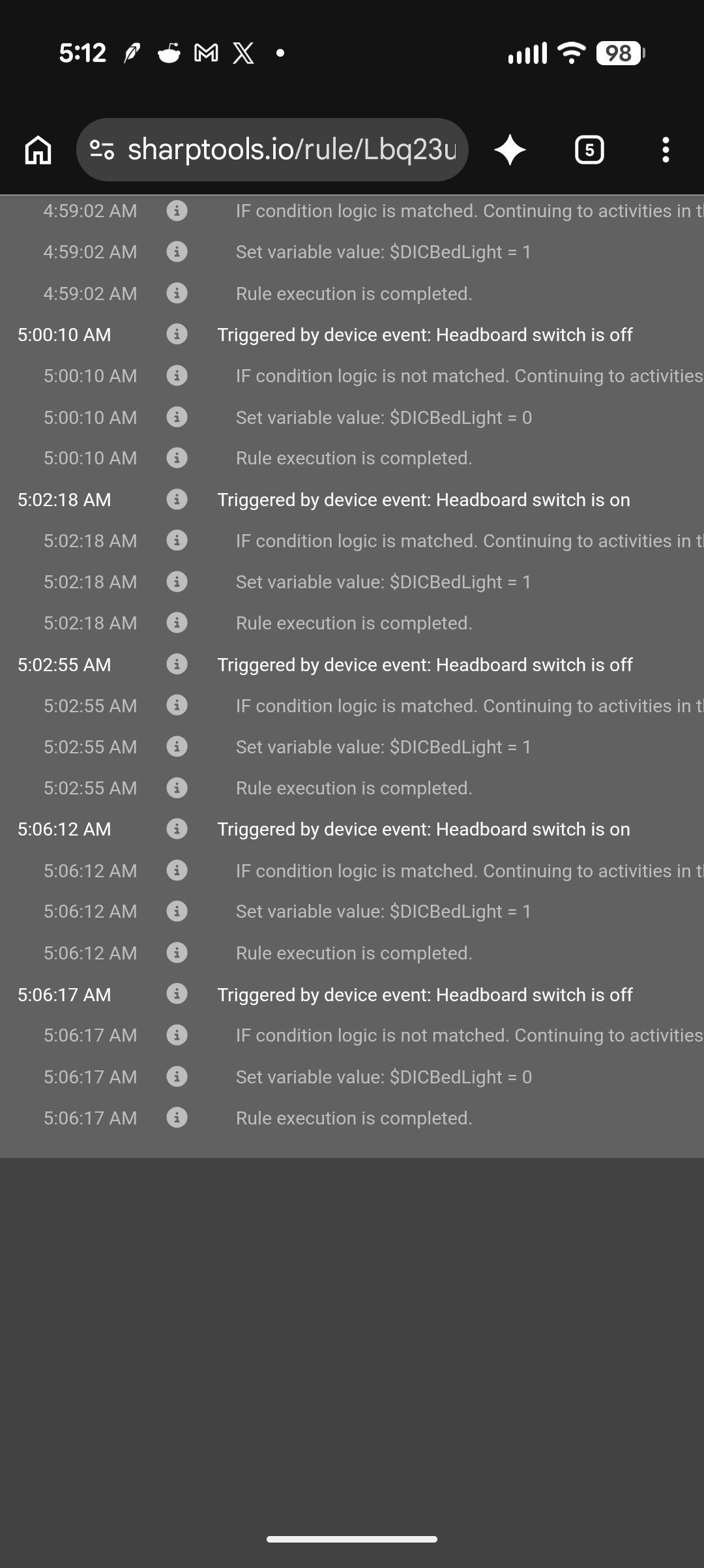

You see here when it’s off. It didn’t set to zero instead set to 1 (which it already was).
Thanks, that log is the example we needed.
At 5:02:55 AM the rule triggered because Headboard switch went off, but the IF still treated it as on and set $DICBedLight to 1. The off events at 5:00 and 5:06 went to ELSE and set 0 as expected.
The IF does not use the event that just fired. It re-reads the last known switch state. That re-read can still say on for a moment after an off event, so the variable stays 1. Downstream rules then look wrong even though the math itself is fine.
The simplest change to your existing rule is to point the IF at the event, not the device: check that the Context Variable $context.event.value is on (instead of Headboard switch is on). Then/Else can stay 1 and 0.
