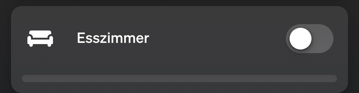

It looks like this. Only sharptools has this problem:
Hue App: Off
Home Assistant: Off
Home Assistant
Sharptools: On

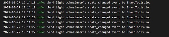

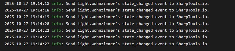

In the sharptools log I can see the triggers:

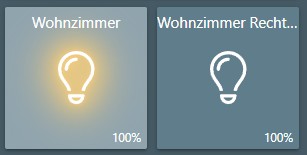

I added now a separate light of the Group “Wohnzimmer Rechts”. This works as expected. Look at this print-screen. All lights are off and the individual light of this group is off and the group on. It’s defintely the group, I tried several times.
