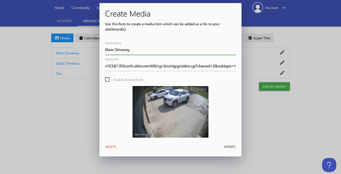

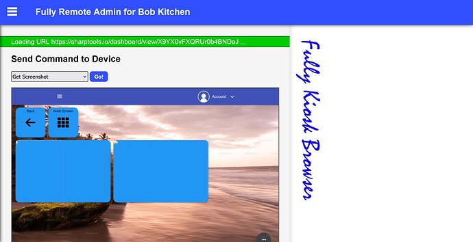

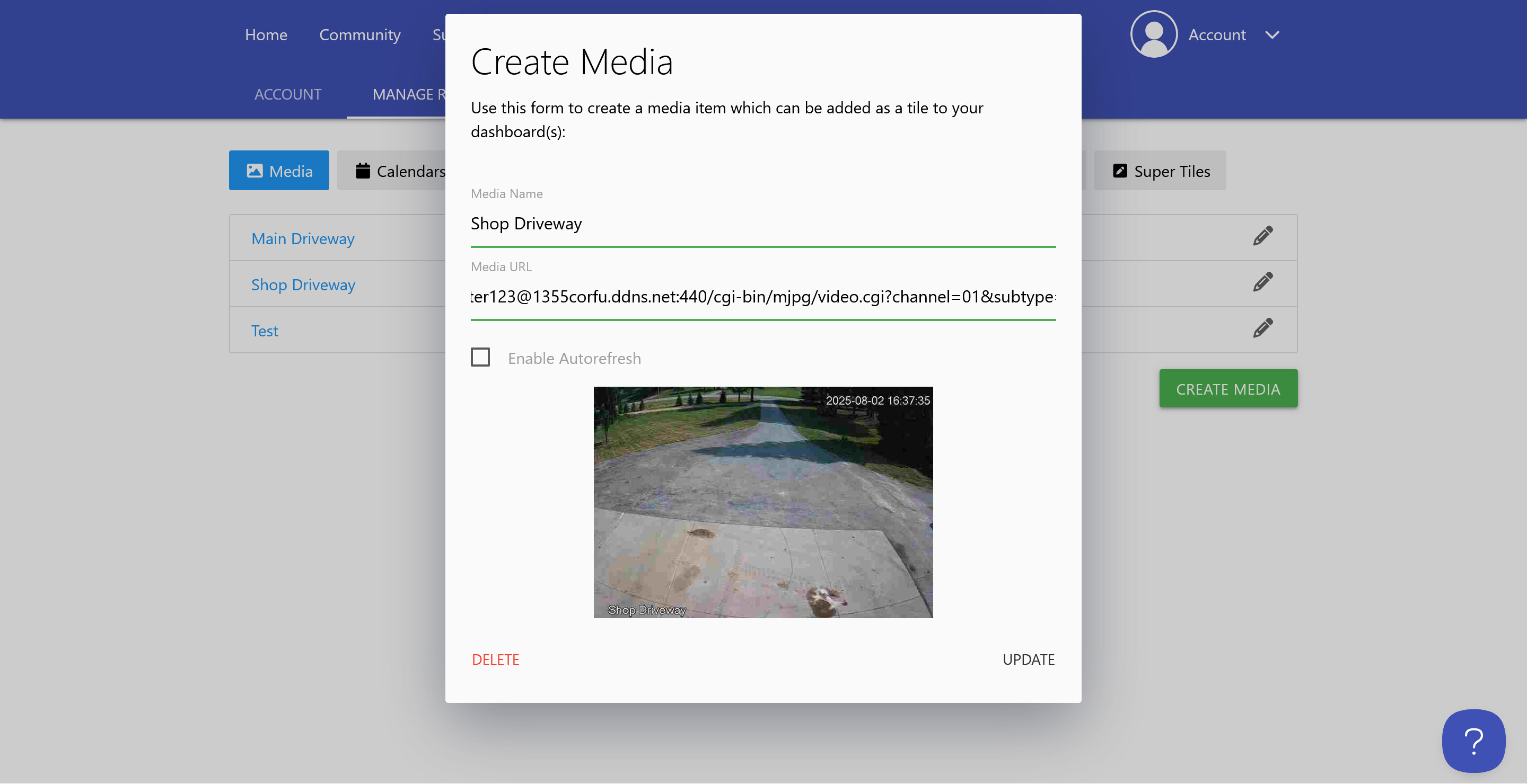

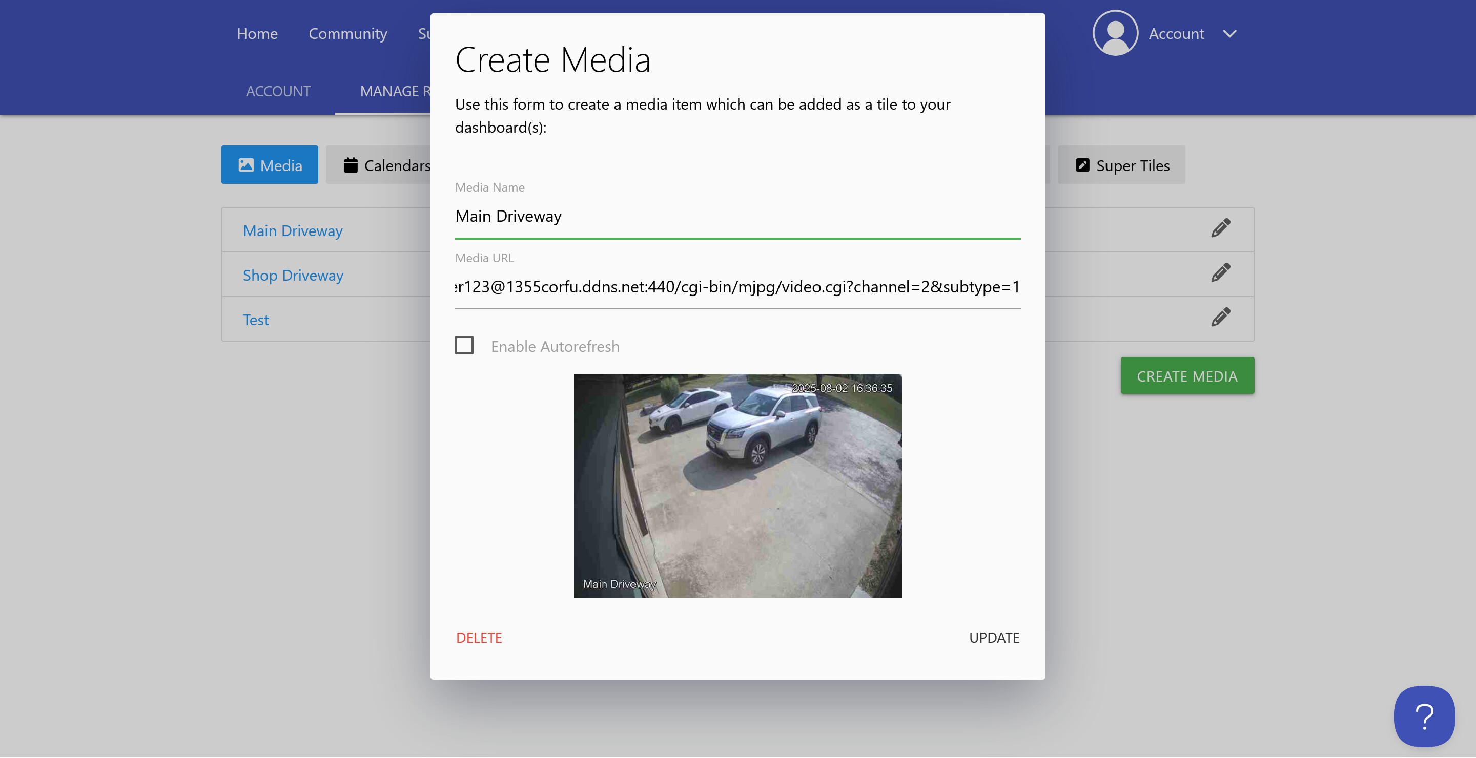

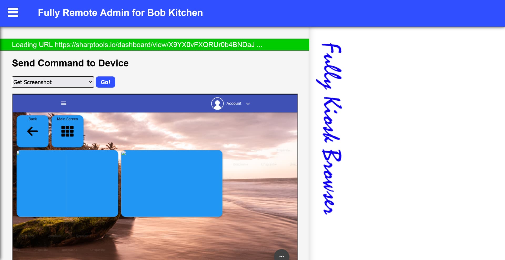

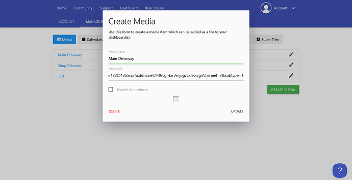

I am using Dahua NVR for the home security cameras. I have set up stunnel and this all works perfectly. I can see the cameras via any laptop or desktop on any browser using the direct URL. In Sharp Tools, I put the links into the resource manager and they become intermittent as to connecting or not. The tablets are just an always, no go. I have attached a couple screen shots and here is a test link to a camera.
https://tester:tester123@1355corfu.ddns.net:440/cgi-bin/mjpg/video.cgi?channel=02&subtype=1
Here is the tablet info from Fully Kiosk cloud access and some screen shots off my laptop. The last screen shot in the Fully Kiosk app is of the tablet with the video page pulled up and no video feeds.
