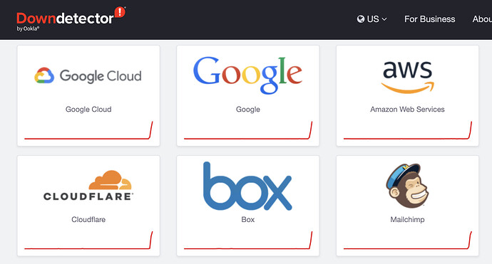

There was a massive widespread outage with Google, AWS, and Cloudflare that lasted a few hours, so if it was around the 12th-13th but isn’t occurring anymore, I suspect it could have been fallout related to that event.
