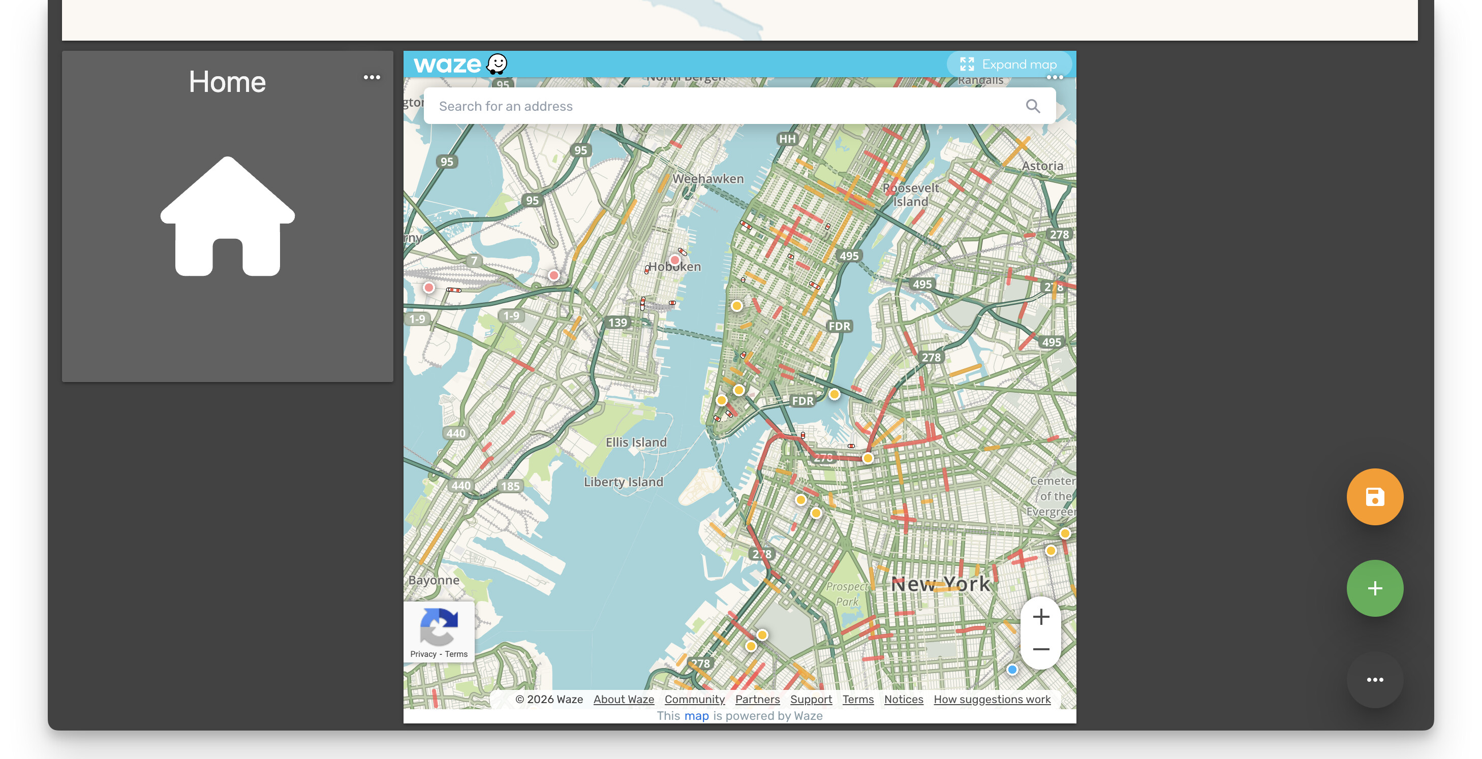

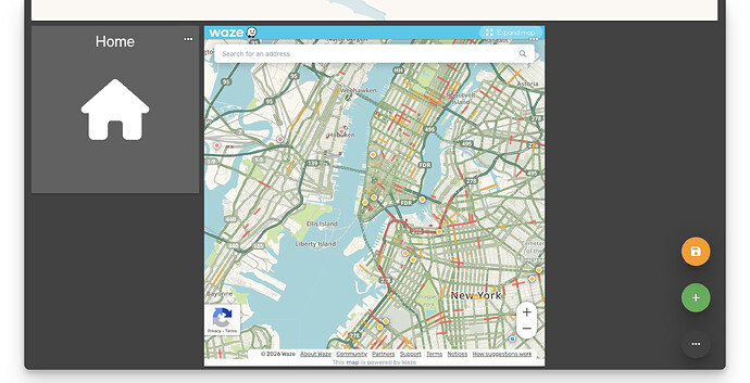

This approach was originally documented by James as it was a neat way to display traffic data using a normal Media Tile, but now that we support Custom Tiles that opens up a much wider range of options.
Waze Traffic Map
For example, Waze offers an embeddable map that you can configure to fit your needs. And you can have it periodically refresh using the Refreshable URL Custom Tile in this thread so it’s displaying up-to-date traffic (though Waze recommends not going overboard with how often you refresh).
NY Traffic: https://embed.waze.com/iframe?zoom=12&lat=40.712775&lon=-74.005973
From a quick search, it seems like there’s a variety of parameters you can tweak:
  • lat/lon — center coordinates
  • zoom — zoom level (0-17)
  • pin=1 — show a pin marker
  • desc=1 — show description text
