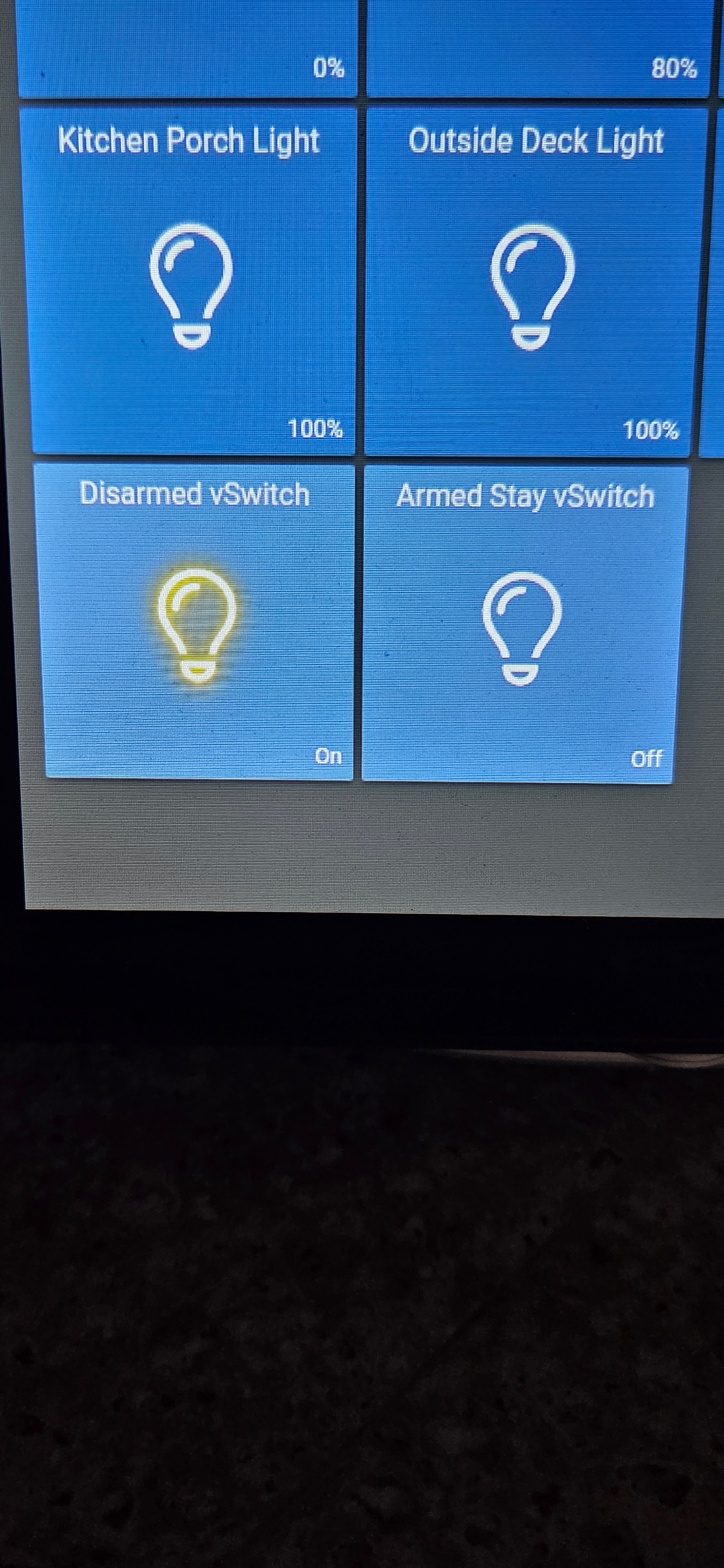

Hey. How did you get the Alarm Armed Away, Stay and Disarm Tiles to show the alarm type icon? Mine are showing like they are light bulbs and under edit it doesn’t have the icons for me to change them. I also added a pic. Thanks
Those Armed Away / Stay / Disarm controls are virtual switches, so SharpTools treats them like any other switch and shows the default lightbulb icons.
You can change the icons on each tile:
  1. Edit the dashboard
  2. Tap ... on the tile → Edit
  3. Open the Icon setting and pick icons for the on/off states
  4. Choose a System icon, or upload your own under the Files tab
Custom icon uploads: Custom Icons (File Uploads) - SharpTools Knowledge Base
