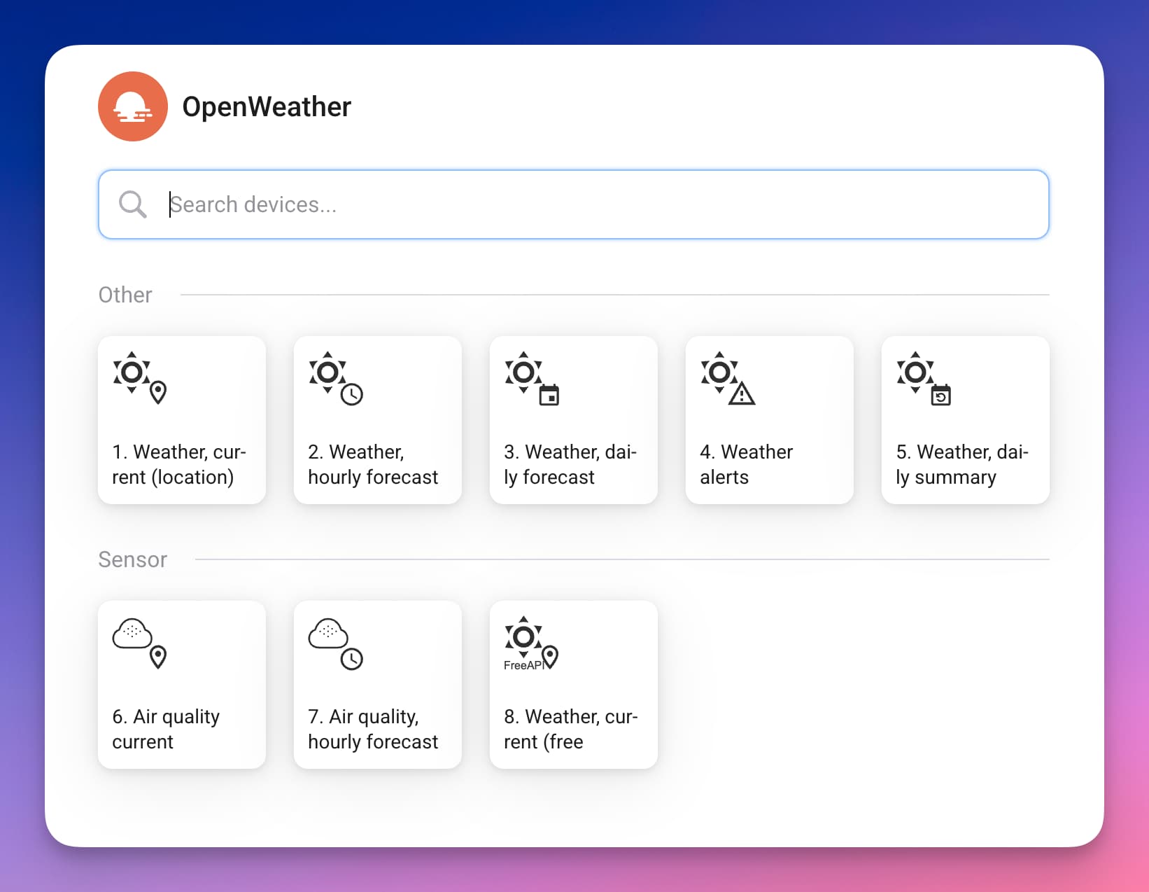

It looks like both devices use the same driver :

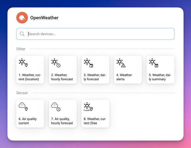

Just an update that I installed the matching OpenWeather Device Driver onto my Homey Pro 2023 and configured both device type 1 and 8 from the following screenshot but I haven’t been able to reproduce the issue.
It looks like device type 8 is the one that matches your screenshots, so I’ve been testing rigorously with that one trying to get it to break, but it seems to consistently report data updates to SharpTools as expected.

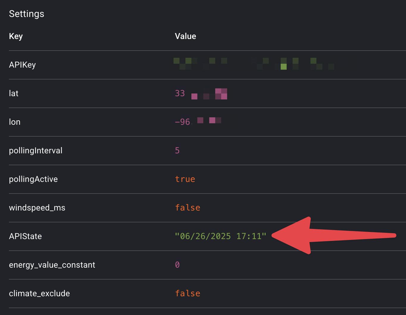

While I haven’t been able to get it to break, I do clearly see the weird behavior where the device updates a hidden APIState device setting when it polls for updated weather data… which is what causes the SharpTools Homey App to see that the device has ‘updated’ and thus it sets up the event listeners again as a safety measure.
But on my side, the consistent 5 minute self-updating of the device’s hidden APIState setting which triggers the app (re)setting up the event listeners has worked consistently and without fail.
