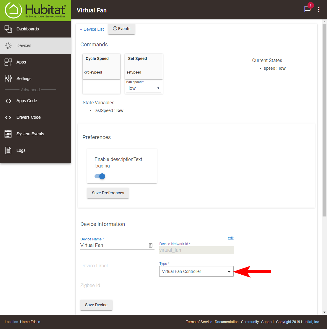

If that doesn’t help, can you please send over a screenshot of the device details page in Hubitat? I’d like to confirm that the device is showing the right details and the new device type is showing as selected under Device Information:
