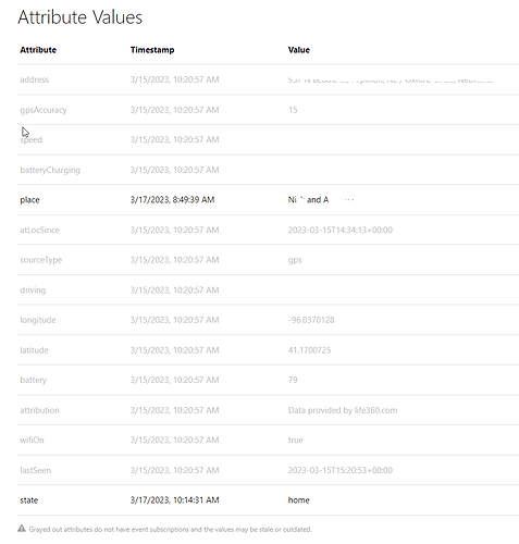

I have an automation that uses the places attribute of a life360 user. I am seeing that its not updating and not allowing the rules to trigger.
I see in home assistant the data is accurate and the place was updated as it should have been from life360.
In sharptools when I look at the attribute data, the place attribute is not updated, and its update time is a couple days old.
While the HA date is updated when it should have been.
Any ideas on how to fix this to be accurate?

Where are you viewing the state of the attribute data in SharpTools? If it’s from the device details screen (under the location details), does the attribute show up in black or grayed out color?
I am using the place attribute as a trigger. Its used as a changed to trigger to know when the person has entered the geo fence.
I am looking at the data in the Home/click the three dots for the HA connecton/choose person
I have added a screenshot of each.

I have seen the same. I switched to using the state attribute as a workaround. I chalked this up as a HA issue. Let me know if logs would still be helpful.
Since the rule does not fire, because the trigger is not tripped , would the logs not be else where?
The logs can be pulled from the Sharp Tools HA Add-on. In my experience the State attribute updates correctly but the Place does not.
