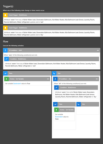

Hello. I just starting using sharp tools (was previously using action tiles). Im trying to make a dashboard tile glow (or even change icon pic) when one of the any devices are in use. I added a variable tile to my dashboard, in the hope for example if one of my water sensors detects a leak, the icon will change.

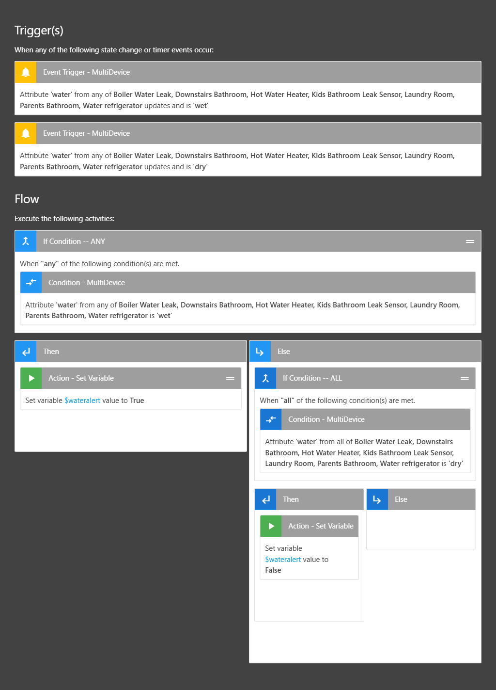

***Update got it working, screenshot of my rule below. Once rule was in I added the variable tile and change icon state/style.
It’s not natively supported as a feature you can just toggle on Dashboard tiles, but you can accomplish it using SharpTools Rules to aggregate the status of multiple devices into a variable… then use that variable in place of your Dashboard tile configured to link to your desired dashboard.
