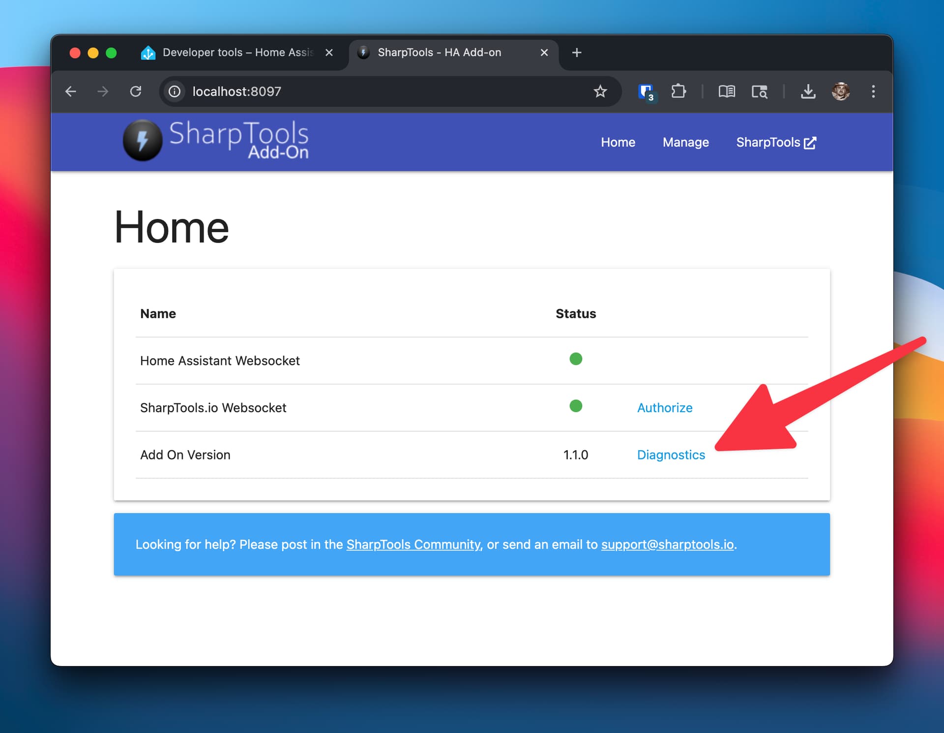

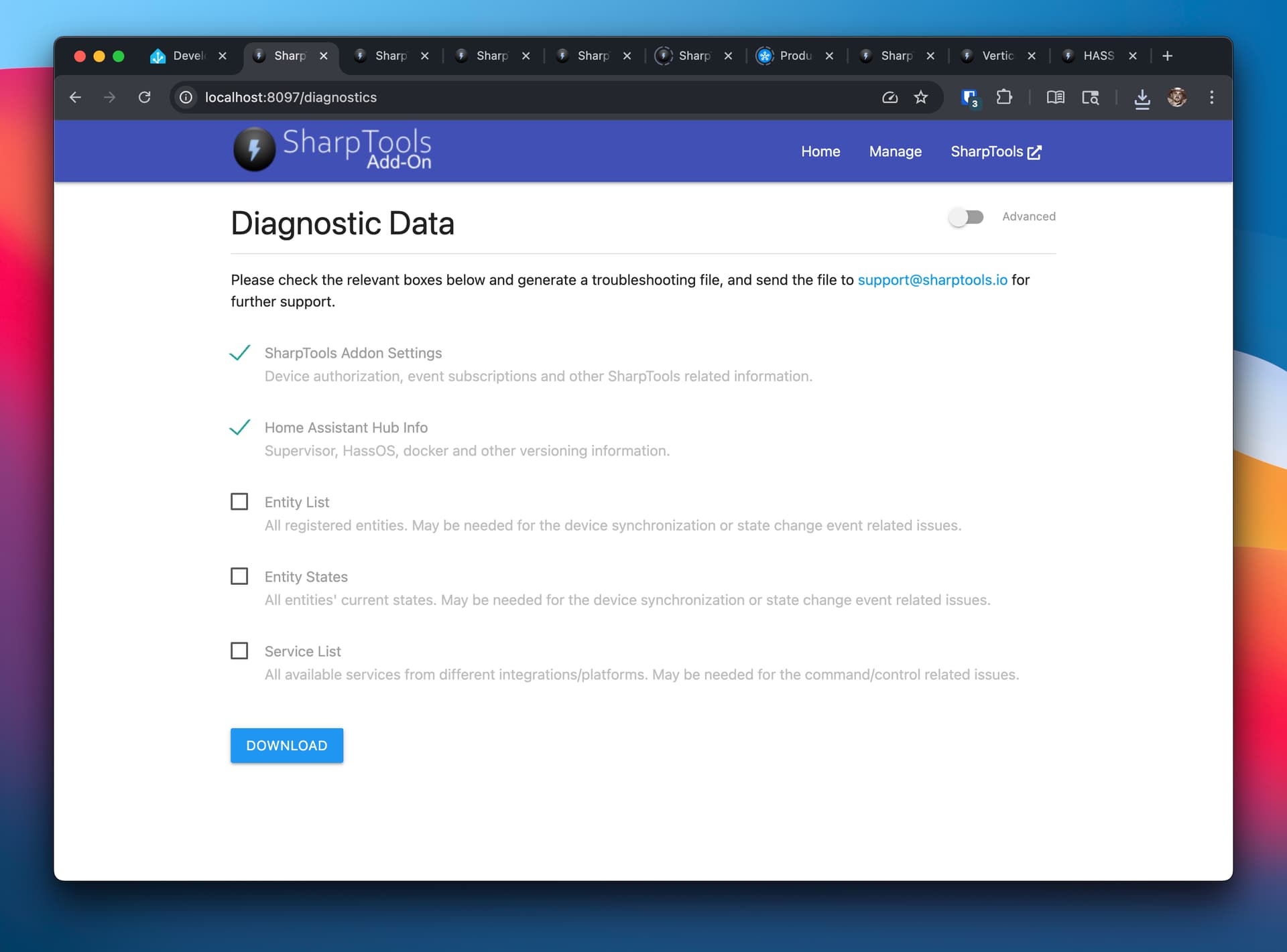

From the SharpTools Add-on, can you tap the Diagnostics link next to the version number on the home screen of the add-on, then download the diagnostics with at least the SharpTools Addon Settings box checked?
Feel free to send the result to support and I can take a look for you – alternatively, read on if you’re interested in reviewing the file yourself.

If you don’t have access to the filesystem where the add-on is running, you could also flip the Advanced toggle on in the top-right corner of the Diagnostic page for the add-on and under Event Subscriptions click the red Reset button.
Note that this approach will delete all of the event subscription settings from the add-on, so you’ll need to then refresh a page where SharpTools is running which will kickoff a background healthcheck which automatically tries to fix any missing event subscriptions.

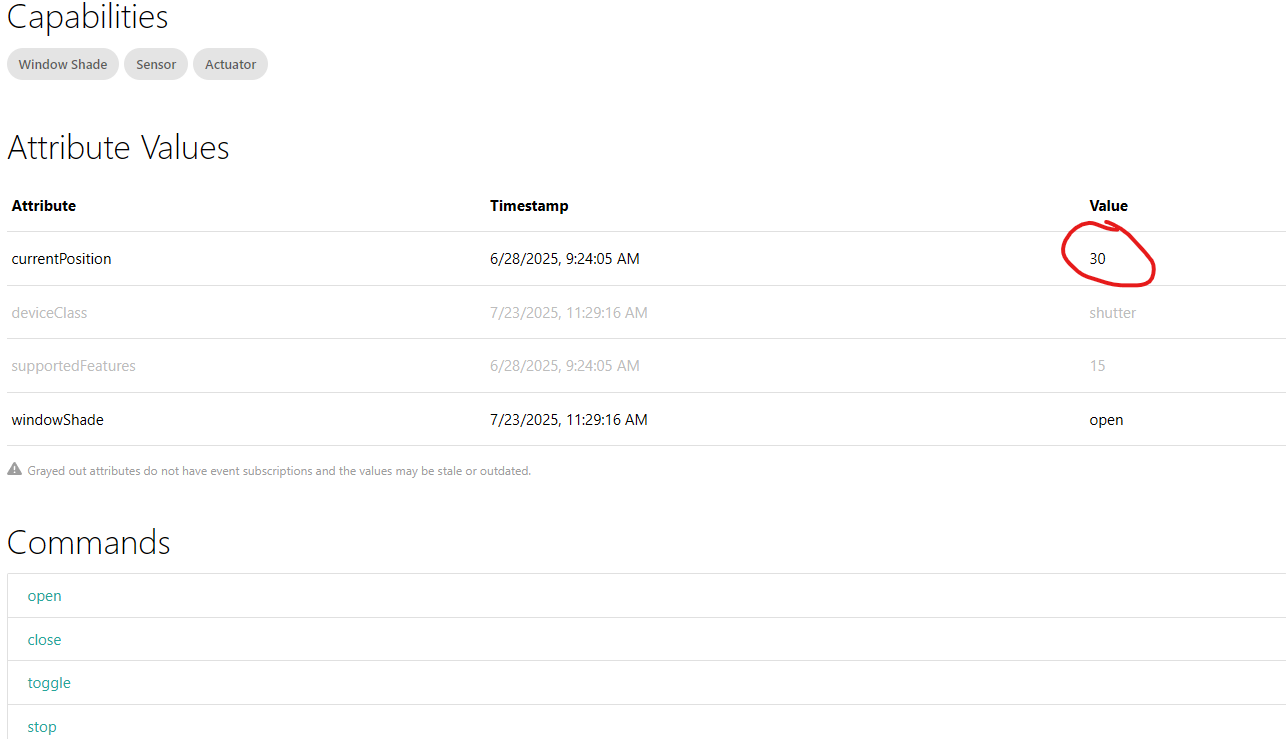

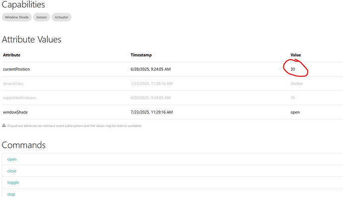

When I navigate to my authorized location and check the blind which updates the slider position, I can see that the value really is instantly updated for that blind, and for another blind that value isn’t updated (please refer to the picture). According to the Timestamp, last update was almost a month ago.
After that, I navigated to Diagnostics, Advanced, hit the Reset and now I messed up even devices which were ok before. To be precise, after the reset at some moment the value updated (according to the Timestamp it was 1 hour ago), but now there is no blind which seccessfully updates it’s status instantly.
