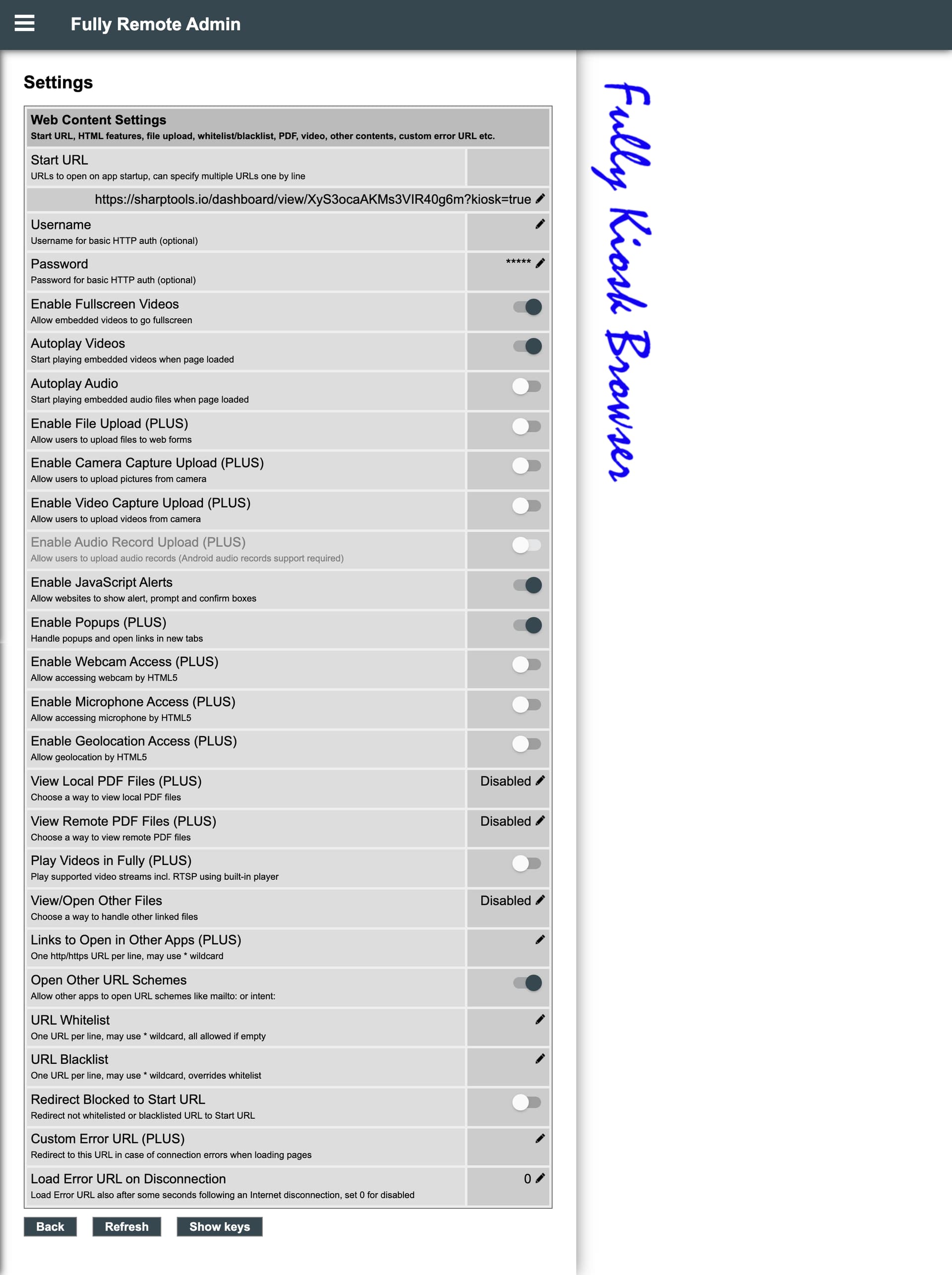

Is there a way to automatically login to SharpTools from the Fully Kiosk Browser? Seems every 2 days I have to log back on from my wall mounted tablets. I’ve entered the username/password in Fully for my home/start URL which is my main dashboard but I still have to manaully enter my credentials.

Will see how it works. Question, do I need my credentials for SharpTools in the Fully Web Content Settings? (there is a location for basic HTTP auth for username/password). I have my SharpTools account entered here.
You don’t need to input username and password in the Fully Web Content Settings. Once you login, the session should keep you logged in until you manually log out.
