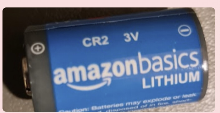

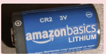

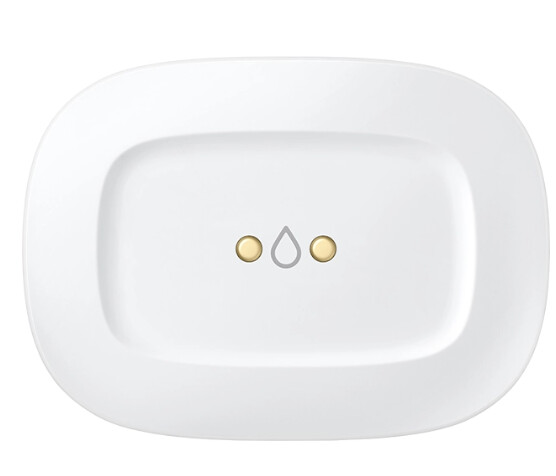

My seven Zigbee Aeotec water sensors are doing extremely well. Lithium(!) batteries, 3 volt, last at least a year. https://aeotec.com/products/aeotec-water-leak-sensor/
No cables needed. They are on four different locations. Some quite far away from the SmartThings router. Do not have to be near the freezers door. In the middle, in between the frozen products is mostly OK.

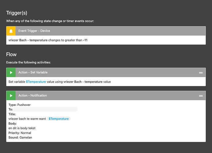

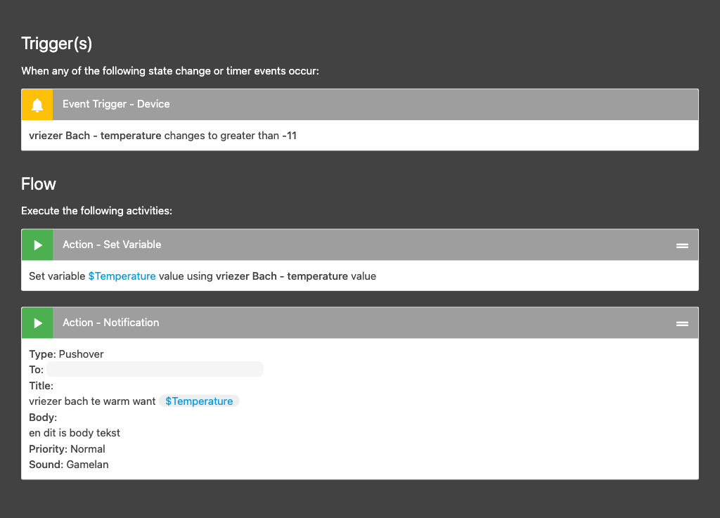

Here is the rule (In Dutch). I also made a variable $temperature, so the message shows the actual temperature of the freezers sensor.

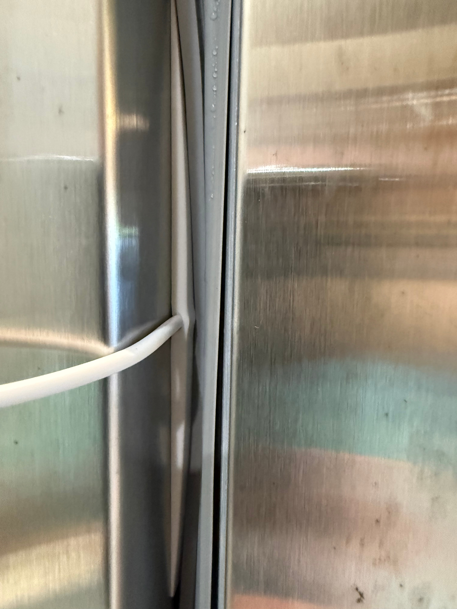

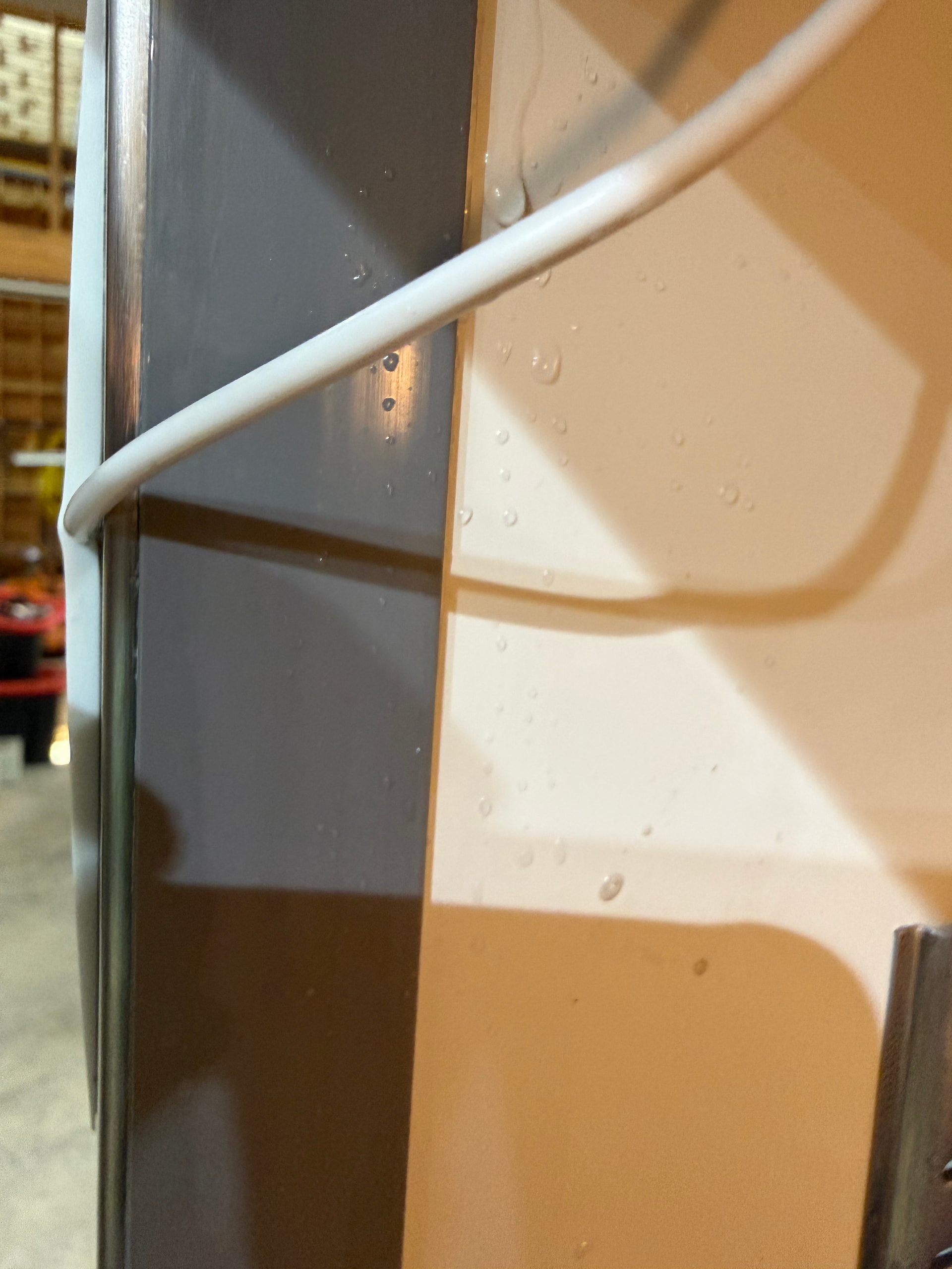

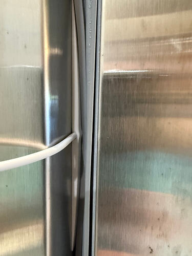

I tried the Sonoff Temperature Sensor (SNZB-02LD) from Amazon. So far, it works really well. The only problem is the wire for the probe is too big which causes a leak around the gasket. It’s not a big leak. But, ice was forming on the inside where the cable went through.
I was able to find a “Fridge Install Kit-TP” from Lascar Electronics. The kit has a tapered plastic piece that improves the seal. See pictures below. Overall, it’s about 5” long by 1/2” wide. This isn’t perfect. But, it seems to have mostly eliminated the leak. (no ice.) Total with shipping was $35.66 which is more than the cost of the Sonoff. It’s also at Alphacontrols.com. Shipping is even higher there.
There was another company that had the same kits. But, you could customize the hole size. Their prices were about $70-$80. I don’t remember the name of the company.
What would be great would be if Sonoff would have the option of a ribbon cable. I suspect that they’ve had problems with durability of a ribbon. It looks like a lot of the thickness of the current cable is just the jacket.
