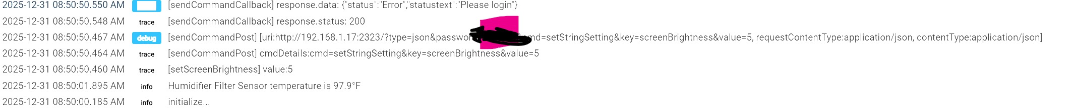

The day that AWS a couple months ago went down “something” changed on my Fire tablets. I lost local control of them from my Hubitat home automation hub. In my logs I see it now asking for a password.
I have a password configured…and have changed nothing on my Fire Tablets or my Hubitat device setup. I’m mean I did change my Amazon account password post the failure. That is irrelevant …right? This is local LAN to local LAN communications…right?
I still see passwords listed in the couple of places in Fully Kiosk….which still match my device config. They still run Fully Kiosk just fine and I can control Hubitat devices as well…IE Tablet to Internet just fine.
