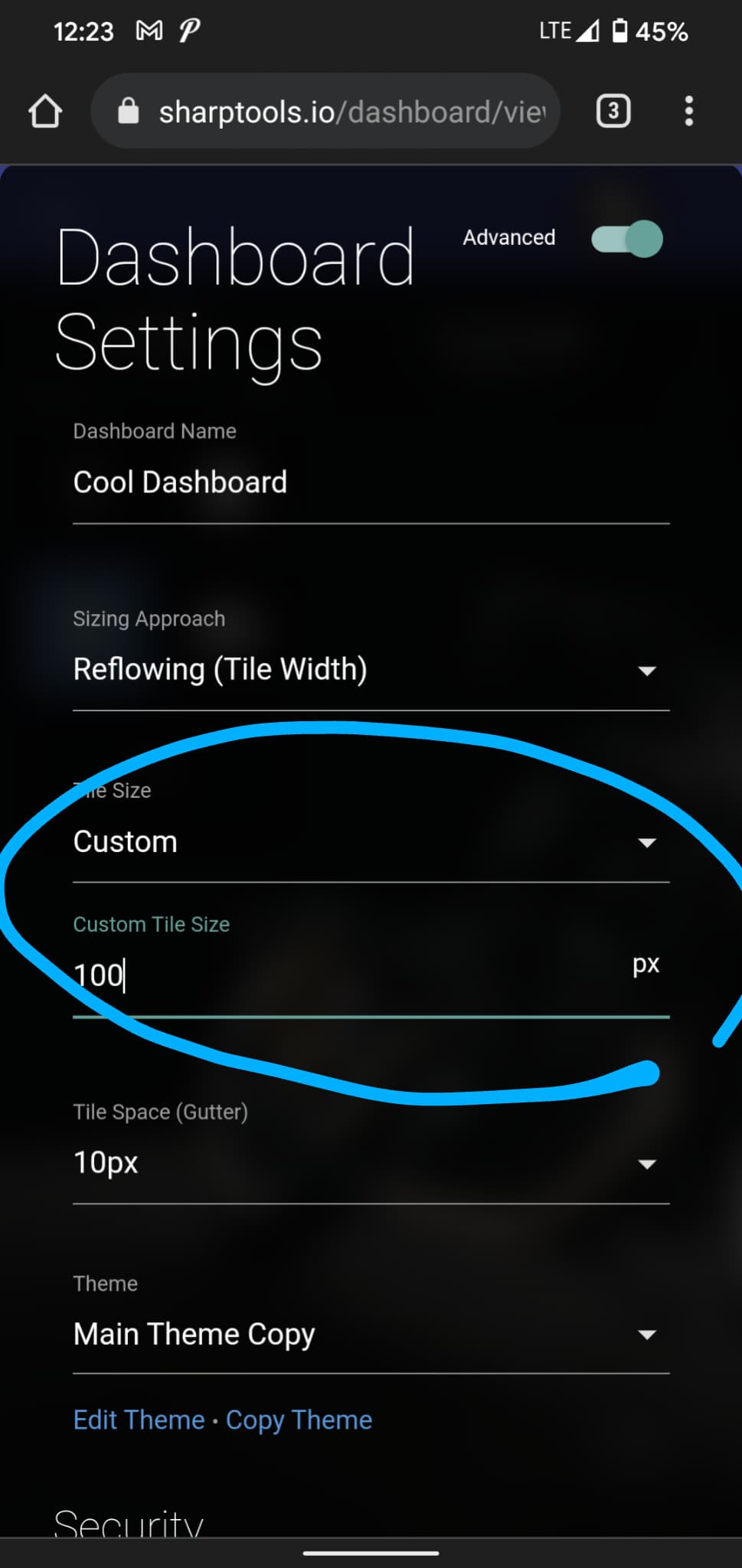

Hi @nbtc971 welcome to the community. You do have the option to specify the tile size in pixel when using ‘reflowing’ option in the dashboard configuration.
So you can play with it and find the optimal tile width in your case. But as you would expect, if the same dashboard is opened on a different device with different resolution, the tiles may flow automatically to best fit the display size while maintaining the specified tile size.

You might also note that in James’ screenshot, the Advanced toggle is flipped on and this gives him access to adjust the Tile Space (Gutter) size. This can sometimes be helpful in tweaking things.

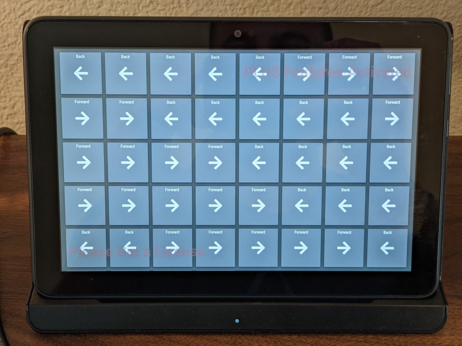

On my 2020 Fire HD 8, using 8 columns wide (with the default gutter size) results in 5 columns high.

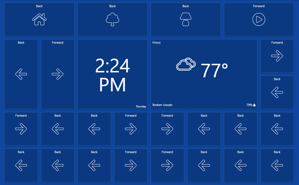

Keep in mind that you can make creative use of dimensions with tiles to achieve some really neat results too. For example, here’s that same 8 wide by 5 tall with some tiles that spread across different dimensions:
