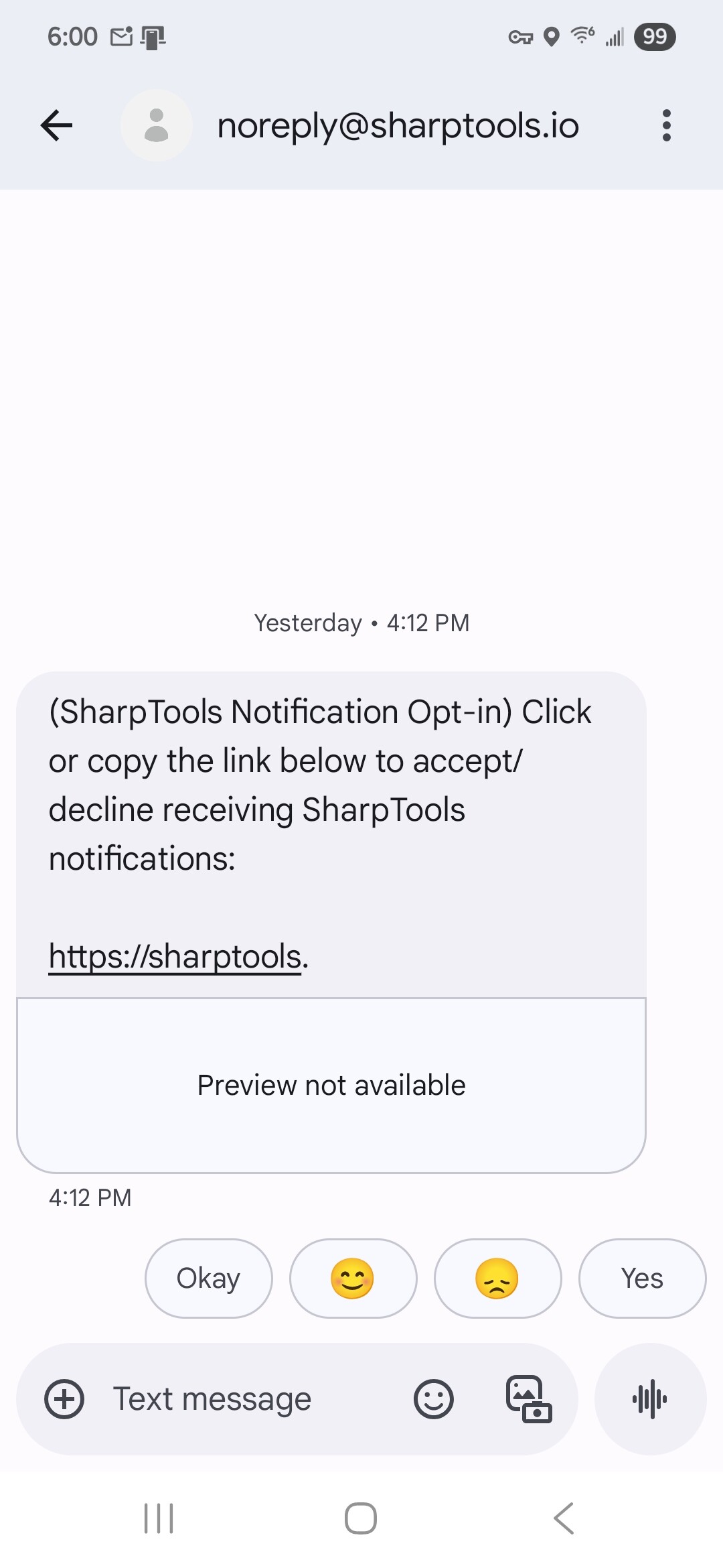

I was trying to activate my email in the Verizon format of **********@vtext.com.
Received a text from noreply@sharptools.io indicating to click on the link in the text to accept or decline the notifications.
However, the link was incomplete. Showed as https://sharptools. Error when clicked was sharptools DNS address could not be found. Diagnosing the problem.

Keep in mind that the email-to-sms translation happens by Verizon. We intentionally keep the email verification message as short as possible to keep it under a standard 140-160 character limit, but it’s still up to the email-to-sms gateway provider to actually format and deliver the message.
Can you share a screenshot of the message? Feel free to redact any sensitive info.

I was trying the email to text approach, that’s when the verification couldn’t be completed.
I wonder if it’s because they inject the subject into the message as that seems to add an additional 33 characters to the message.
The length of the message up to where it’s cutoff in your screenshot is 137 characters including the injected subject which is right up against the 140 character count we try to stay under, so it’s probably the injection of that subject by Verizon’s Email-to-SMS gateway that’s causing the trouble.
That being said, most carriers usually automatically split messages into multi-part SMS and reassemble them when delivered if they’re longer than their character, but again I guess Verizon’s Email-to-SMS gateway doesn’t do that. :man_facepalming:

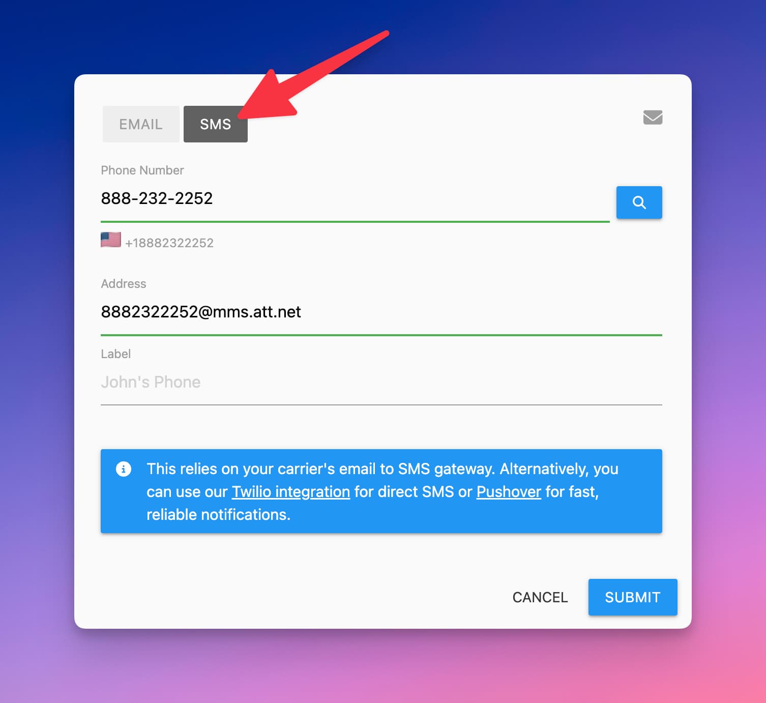

I took a quick look at how we could potentially shorten the mobile version of our validation message and realized it should already be under the 140 character limit even if the carrier embedded the subject into the message.
If you want to try Verizon’s email-to-SMS gateway again, you can try removing the pending @vtext.com address and try it again using the SMS tab when adding an extra email to your account.

Per the image at the top of this post, the ‘mobile’ flag only gets set if you explicitly use the SMS tab when adding an additional email. If you manually enter an email using the EMAIL tab, it’s treated like a normal email.
Just an update that we added some logic that detects common email-to-sms gateway domains (like @vtext.com) and automatically tags those email addresses as ‘mobile’ so they get the shorter SMS-friendly email opt-in. :slight_smile:
