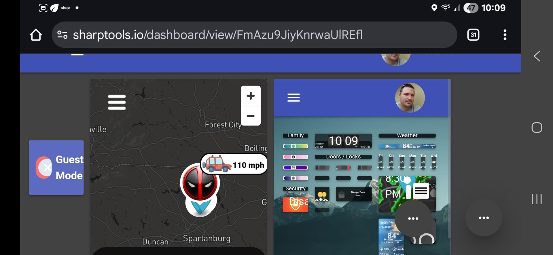

Is there a way to put a dashboard ON a dashboard? Not just a link to it.
If I made the group of tiles a dashboard, and was able to just add that dashboard to the existing one, that would be nice. (this is an arrangement thing)
If GARAGE was a dashboard (red box)
It can be done you have to use a custom tile.
Here is the code I used.

<meta http-equiv="refresh" content="0; url=https://sharptools.io/dashboard/view/{your_dashboard}">
Thanks Jake!
Any way to crop off the top so it doesn’t have the blue header? It does work though.
Yes, you should be able to add ?kiosk=true to the end of the url.
Yep- That did it!

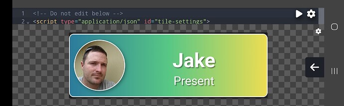

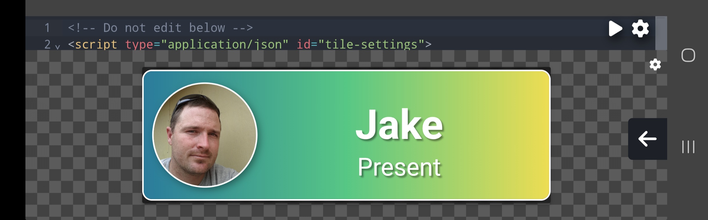

I used custom tiles to mainly give my tiles a different UI.
This is a custom tile for presence sensors.
